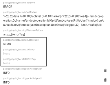

- Find the maxLogFileSize, maxHistory, and totalSizeCap properties (shown below).
- Edit any of the following properties to set them to the desired values:
- pax.logging.logback.maxLogFileSize: This property sets the maximum file size for anzo_full.log. When the maximum size is reached, Graph Studio stops writing to that file and creates a new one.
- pax.logging.logback.maxHistory: This property specifies the maximum number of historical anzo_full.log files to keep. When this limit is reached, Graph Studio deletes the oldest file.
- pax.logging.logback.totalSizeCap: This property sets the total size limit for all anzo_* log files combined.
