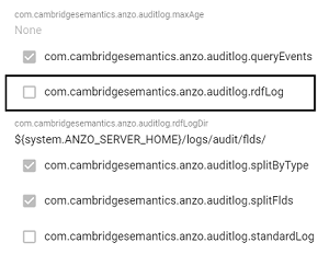

  4. Find the com.cambridgesemantics.anzo.auditlog.rdfLog property (shown below).
  5. Click the property to make it editable, and then select the checkbox to enable it.
  6. Click the checkmark icon () to save the change.
