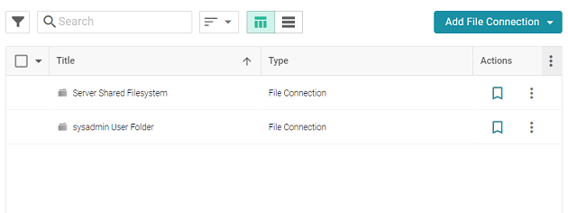

- In the Administration application, expand the Connections menu and click File Store. Graph Studio displays the File Store screen, which lists existing file store connections. For example:

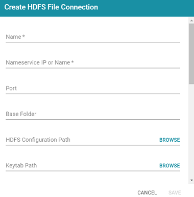

HDFS File Connection
If you use Kerberos Authentication with HDFS, you must also configure the Graph Lakehouse cluster to authenticate with Kerberos. For instructions, see Configuring Graph Lakehouse for Kerberos Authentication.
Setting | Description |
Name | The name to use for this file connection. |
Nameservice IP or Name | The IP address or host name for the storage system. |
Port | The RPC port to access the server on. The default RPC port is 8020. |
Base Folder | The base or root folder on the file system where you want Graph Studio to read or write files. Each time Graph Studio generates new files it creates a new subdirectory under this base location. |
HDFS Configuration Path | The full path to the configuration files. |
Keytab Path | The full path to the keytab file. |
Password
Confirm Password |
The password for the account used to access the server. |
Nameservice Rest IP or Name | The HTTP REST IP address or host name. Typically this value is the same as the Nameservice IP or Name . |
Nameservice Rest Port | The HTTP port. Graph Lakehouse uses this port to access HDFS and load the FLDS. The default HTTP port for the namenode is 9870. |
Nameservice Rest Protocol | The protocol to use for requests. Choose one of the following values:
Globally accessible filesystem | Select this option if this file store is accessible by all of the servers in an Graph Lakehouse cluster. If only the leader server can access this system, leave this option blank. |

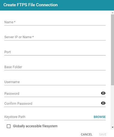

FTP or FTPS File Connection
Server IP or Name | The IP address or host name for the storage system. |
Port | The port to access the server on. |
Username | The user name for the account used to access the server. |
Password
Confirm Password |
Keystore Path | For FTPS connections, the full path to the keystore file. |

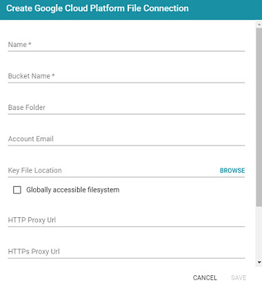

Google Cloud Platform File Connection
Bucket Name | The name of the bucket to store files in. |
Account Email | The email address for the account used to access the storage. |
Key File Location | The full path to the keystore password file. |

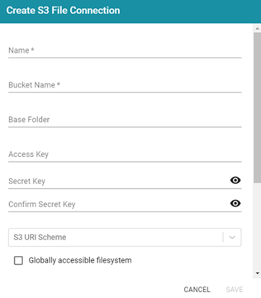

S3 File Connection
When using Amazon S3 for file storage, do not use client-side encryption, where data is encrypted before it is sent to S3. Graph Studio cannot read files on S3 if the object store uses client-side encryption.
Access Key | The Access Key ID to use for accessing the S3 location. |
Secret Key
Confirm Secret Key |
The Secret Key ID for the Access Key. |
S3 URI Scheme | Specifies whether the URI scheme is S3, S3 Native, or S3A. |
