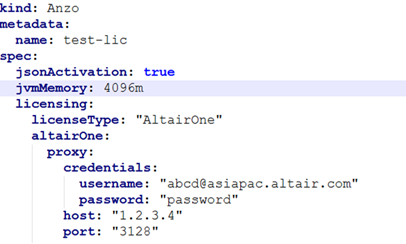

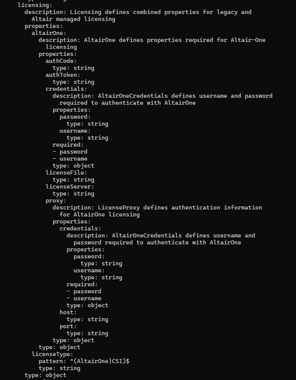

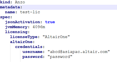

To specify licensing at the bootstrap time of Graph Studio, we need to specify a set of parameters in the deployment YAML file section spec.Licensing
There are multiple ways to specify license credentials, depending on the setup / account that you have. Altair Units Licensing provides two options: Managed Licensing (with license hosted in the Altair cloud) and self-hosted Altair License Server. Cambridge Semantics legacy license is also supported for a limited time to ease the transition to the new licensing system for existing customer. The following configuration settings are supported:
  1. spec.licensing.altairone.credentials - For Managed Altair Units Licensing, you can specify Altair One account credentials here (basic authentication using username and password).
  2. spec.licensing.altairone.authCode - Alternatively, with Managed Altair Units Licensing you can generate an authorization code from the Altair One account profile and use it to deploy the server.
  3. spec.licensing.altairone.proxy - HTTPS proxy details for Managed Altair Units Licensing. If an HTTPS proxy is used, specify the proxy host and port, proxy username and password (if applicable).
  4. spec.licensing.altairone.licenseServer - Self-hosted (on-premises) Altair License Server address in the form of <port>@<server_name_or_IP_address>.
  5. Cambridge Semantics legacy license file can be specified in the file /opt/anzo/Server/configuration/firstbootFiles/init.json under the key 'licenseEncoded'. (Not recommended)
Examples
Managed Altair Units Licensing configuration with Altair One credentials specified:
Managed Altair Units Licensing configuration with HTTPS proxy specified:
