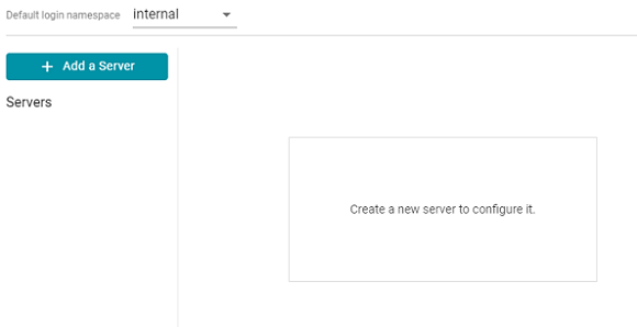

- In the Administration application, expand the User Management menu and click Directory. Anzo displays the Directory screen. For example:

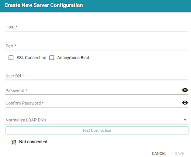

- On the Directory screen, click the Add a Server button. Anzo displays the Create New Server Configuration screen.
- Enter the connection details for the server:
- Host: The host name or IP address for the directory server.
- Port: The port to use to connect to the directory server.
- SSL Connection: Indicates whether the directory server uses an SSL connection. Select the SSL Connection checkbox to enable the SSL connection. If you use SSL, make sure that you load the directory server's certificate to the Graph Studio trust store. See Adding a Certificate to the Trust Store for instructions.
- Anonymous Bind: This option indicates whether you want Anzo to connect to the directory server anonymously. To avoid Graph Studio login problems when enabling this option, make sure the directory server allows anonymous binding and searches when bound anonymously. Select the Anonymous Bind checkbox to enable anonymous binding.
- User DN: The full distinguished name of the account that Graph Studio will bind against to perform searches on the directory server.
- Password and Confirm Password: The password for the User DN.
- Normalize LDAP DNs: To ensure that duplicate user accounts are not created in Graph Studio if an LDAP distinguished name has both a lowercase and uppercase version, you can configure the system to normalize distinguished name strings so that values that differ only in capitalization are treated as the same value. If you do not want distinguished names to be normalized, leave the field blank or select None. To normalize distinguished names to lowercase, select Lowercase, or select Uppercase if you want names to be normalized to uppercase.

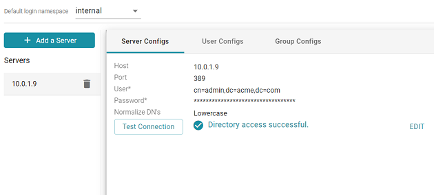

- Graph Studio attempts to connect to the server automatically. If the connection fails, make sure that you entered the correct connection details. You can also click Test Connection to check if Graph Studio can connect to the server.
- Click Save to save the server configuration and return to the Directory screen. The new server configuration is selected on the screen. For example:

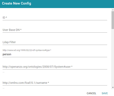

- On the Directory screen, click the User Configs tab. Then click the Create New User Config button. Graph Studio displays the Create New Config dialog box.
- Complete the following required fields and specify the optional values as desired. Each time you map an attribute, Graph Studio displays some samples of the values it retrieves for that attribute. If the specified attribute does not match an attribute in the system, Graph Studio displays an "LDAP Attribute unavailable" message.
- ID: Required setting that defines the unique name for this user configuration. Graph Studio uses this value as a namespace for usernames in case you connect to multiple directories with conflicting names.
- User Base DN: Required setting that specifies the LDAP distinguished name.
- LDAP Filter: The optional LDAP filter to apply when searching for users (usually left blank).
- http://www.w3.org/1999/02/22-rdf-syntax-ns#type: Required setting that specifies the LDAP class of the type of accounts that should be logged on. Typically person.
- http://openanzo.org/ontologies/2008/07/System#user: Required setting that specifies the LDAP attribute that contains user login information. Typically uid.
- http://xmlns.com/foaf/0.1/surname: Required setting that specifies the LDAP attribute that contains users' surnames. Typically sn.
- http://xmlns.com/foaf/0.1/name: Required setting that specifies the LDAP attribute that contains users' full names. Typically cn.
- http://xmlns.com/foaf/0.1/givenname: Required setting that specifies the LDAP attribute that contains users' first names. Typically givenName.
- http://xmlns.com/foaf/0.1/title: Optional value that specifies the LDAP attribute that contains users' job titles. Typically title.
- http://www.w3.org/2003/06/sw-vocab-status/ns#term-status: Optional value that specifies the status at the level of terms.
- http://xmlns.com/wot/0.1/src_assurance: Optional value that specifies the source for Assured Replication.
- http://xmlns.com/foaf/0.1/phone: Optional value that specifies the LDAP attribute that contains user phone numbers. Typically telephoneNumber.
- http://xmlns.com/foaf/0.1/mbox: Optional value that specifies the LDAP attribute that contains users' email addresses. Typically mail.
- http://openanzo.org/ontologies/2008/07/Anzo#location: Optional value that specifies the LDAP attribute that contains user location information.
- http://openanzo.org/ontologies/2008/07/Anzo#isInternalUser: Optional boolean value that indicates whether users are Anzo internally managed users.
- http://xmlns.com/foaf/0.1/img: Optional value that specifies the LDAP attribute that contains images for users.
- http://purl.org/dc/elements/1.1/description: Optional value that specifies the LDAP attribute that contains user descriptions. Typically description.
- http://openanzo.org/ontologies/2008/07/Anzo#defaultGroup: Optional value that specifies the LDAP attribute that contains the value of users' Graph Studio Default Group assignment.
- http://openanzo.org/ontologies/2008/07/Anzo#companyDepartment: Optional value that specifies the LDAP attribute that contains user department information. Typically department.
- http://xmlns.com/wot/0.1/assurance: Optional boolean value that indicates whether Assured Replication is enabled.
- When you have finished mapping attributes, click Save to save the user configuration.

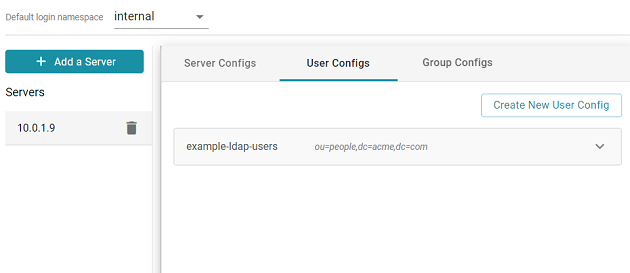

The new user configuration is added to the system and Graph Studio returns to the Directory screen, which shows the newly created configuration. For example:

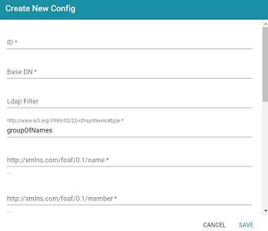

- On the Directory screen, click the Group Configs tab. Then click the Create New Group Config button. Graph Studio displays the Create New Config dialog box.
- ID: Required setting that defines the unique name for this role configuration.
- Base DN: Required setting that specifies the LDAP distinguished name that contains all of the system roles.
- LDAP Filter: The optional LDAP filter to apply when searching for roles (usually left blank).
- http://www.w3.org/1999/02/22-rdf-syntax-ns#type: Required setting that specifies the group object class of the type of roles. Typically groupOfNames.
- http://xmlns.com/foaf/0.1/name: Required setting that specifies the LDAP attribute that contains the names of the roles.
- http://xmlns.com/foaf/0.1/member: Required setting that specifies the LDAP attribute that contains common member attributes. Typically member or uniqueMember.
- http://openanzo.org/ontologies/2008/07/Anzo#usedBy: Optional value that specifies how the role is used by Anzo.
- http://openanzo.org/ontologies/2008/07/Anzo#permission: Optional value that specifies the LDAP attribute that contains the Anzo permissions to assign to the roles.
- http://purl.org/dc/elements/1.1/description: Optional value that specifies the LDAP attribute that contains role descriptions.
- http://purl.org/dc/elements/1.1/date: Optional value that specifies the LDAP attribute that contains role dates.

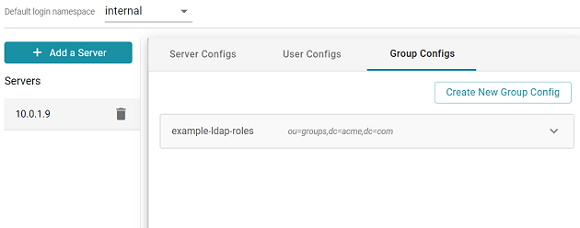

- Click Save to save the role configuration. The new role configuration is added to the system and Graph Studio returns to the Directory screen, which shows the newly created configuration. For example:

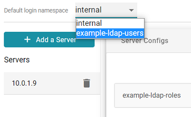

- The last step in configuring the connection is to designate the default login namespace. This is the namespace to default to if a user does not fully qualify their username with the
@namespacesuffix when they log in to Graph Studio. To set the default namespace, click the Default login namespace drop-down list at the top of the screen and select the desired default namespace. Typically users select the newly added connection. It is displayed as the ID value from the user configuration. The "internal" namespace is the embedded Graph Studio LDAP server for local users.For example, the image below shows the available namespaces based on the example configuration in the steps above. If the
example-ldap-usersnamespace is selected as the default, users who have only local Graph Studio accounts need to specifyusername@internalwhen they log in. But users with accounts in the example-ldap-users server can log in withusername. The@namespaceis not needed.
