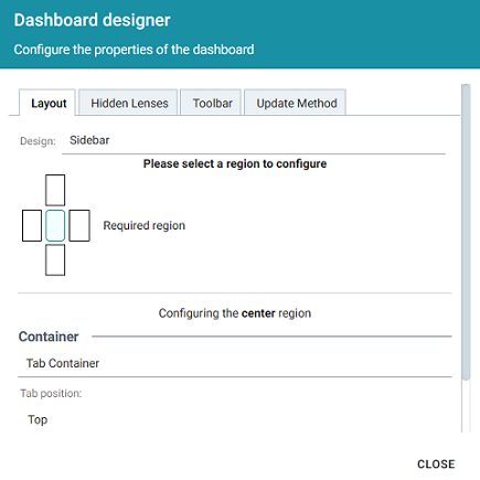

  2. In the main toolbar, click Designer to open the dashboard designer. For example:

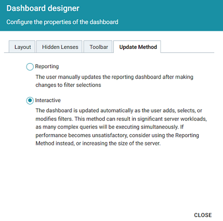

  3. In the designer, click the Update Method tab. The image below shows the Update Method tab for a dashboard that is in Interactive mode.
  4. Click the radio button for the update mode that you want the dashboard to use. Then click Close to close the designer.

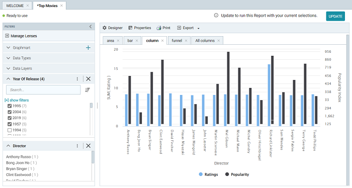

When a dashboard is in Reporting mode, an Update button is displayed on the top right corner of the dashboard. The button is disabled when the dashboard is up to date. The image below shows the disabled button.

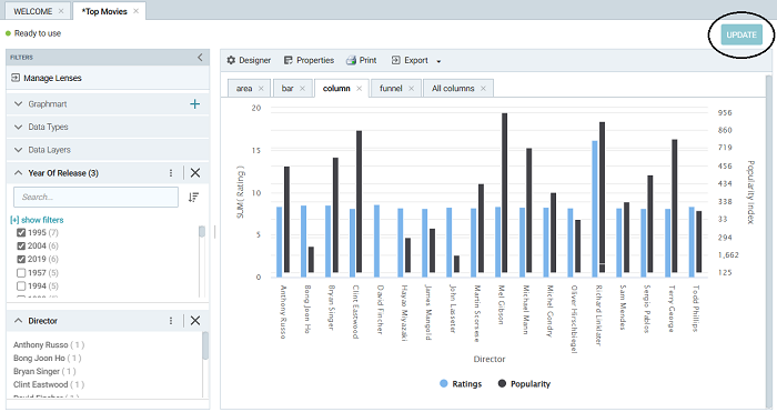

When a user makes a change to a component, the Update button is enabled (as shown in the image below) and the dashboard can be refreshed as needed. When the update is initiated, all lenses are refreshed.

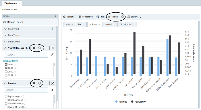

  2. In the main toolbar, click the Refresh menu and select Show Update Controls. A pause icon and status icon are added to each filter and lens on the dashboard, as shown in the image below.
    The pause icon () is used to pause or re-enable automatic updates of the component, and the status icon indicates whether the component is up-to-date () or out of sync ().

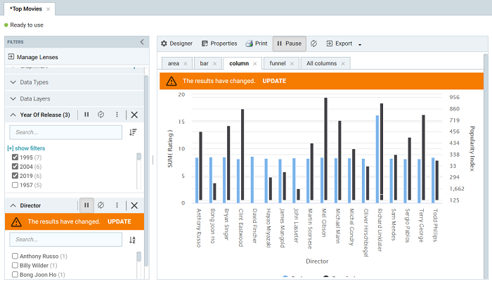

When a filter or lens is paused and a user makes an update that affects that component, an update message is displayed. For example, the image below shows a lens and filter that are out of sync. Clicking UPDATE in the message refreshes that component.
