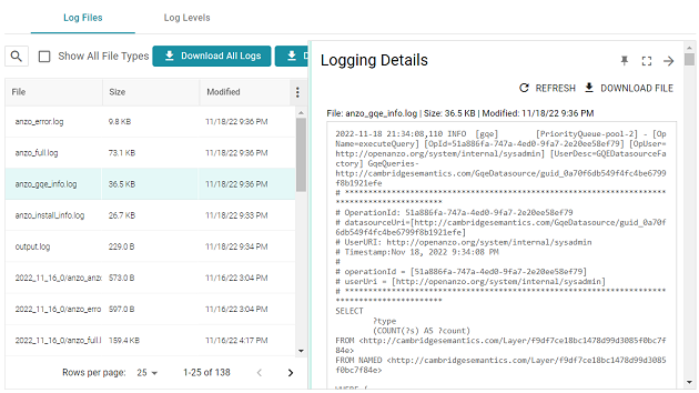

  2. Select the anzo_gqe_info.log file. The contents of the file are displayed in the Logging Details section of the screen. For example:

The messages in anzo_gqe_info.log vary by the query source, such as whether the query originated in a dashboard lens or the Query Builder. In general, GqeQueries Info messages contain the following information:
  • Date and time the event was logged. For example, 2021-04-28 01:06:48.
  • The type of message, i.e., the Log Level, such as INFO.
  • The type of log. For example, [gqe].
  • The area of the system or service that processed the event. For example, [PriorityQueue-pool-2].
  • The Log Package that was listening for the event, i.e., GqeQueries.
  • The Data Source URI. For example, http://cambridgesemantics.com/GqeDatasource/guid_e1f38b640fe04bf8fee71bdf5184bf41.
  • The Operation ID assigned to the query. This value can be used to track the query, such as to find the individual log file in the logs/gqe/queriesInfo directory. For example, OperationId: 7b0op0wbzqeqe1s2d482xudkez-83. The corresponding log file is named query_7b0op0wbzqeqe1s2d482xudkez-83.log.
  • The User URI for the user who submitted the query. For example, UserURI: ldap:///cn=Jay.Blue,ou=groups,dc=com.
  • If the query was submitted from the Hi-Res Analytics application, the message also includes details for identifying the dashboard and lens that submitted the request. For example:
    # ex_requestDashboard = [http://cambridgesemantics.com/354db630-02b6-46b2-82d0-ef4a7543ebca]
    # ex_requestSource = [http://cambridgesemantics.com/4a039bdb-bdcb-4117-830b-cb29190ce18f]
    # ex_requestSourceId = [com_cambridgesemantics_application_anzoweb_lens_grid_GridLens_7]
  • The text of the query that was sent by Graph Studio. Note that the text is the query as rewritten by Graph Studio and sent to Graph Lakehouse. It may not be the exact text that was written by the user.
  • When a query returns, a result message is also added to anzo_gqe_info.log below the query text. The QueryResults message includes the Operation ID (which matches the ID from the query that was sent), and it returns the Graph Lakehouse and Graph Studio query execution time as well as the number of results returned. In the following example, the QueryResults message is shown in bold. The first value (2631) is the number of milliseconds Graph Lakehouse spent executing the query. The value in brackets ([13155]) is the number of milliseconds Graph Studio spent executing the query. And the last value (20) is the number of results that were returned.
