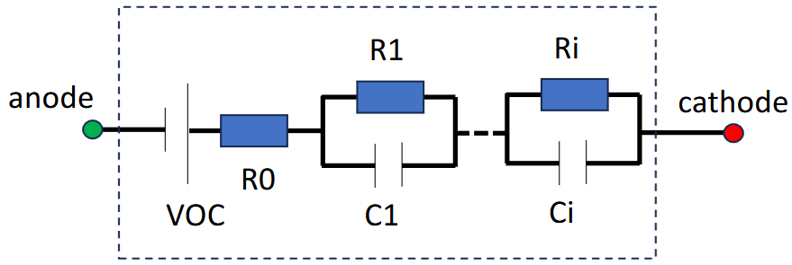

  2. The circuit of a BCELL element is shown as below.
    Figure 1. Details of a CELL element
