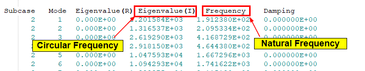

In the .out file, for the complex modes, the complex eigenvalue is the same as the circular frequency, while the frequency printed is the natural frequency.
Figure 1. Complex eigenvalue table in the .out file

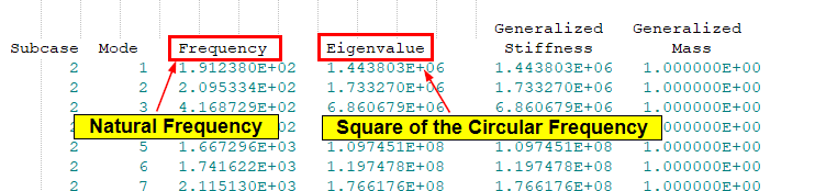

For the real modes, the eigenvalue printed is the square of the circular frequency.
Figure 2. Real eigenvalue table in the .out file
