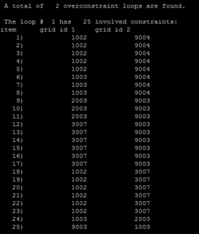

  6. Over-constraint check information is printed in the .out file when JOINTG degrees of freedom are over-constrained. This is currently only available when the JOINTG entry is in the model, and if multiple constraints apply on the same degree of freedom. These multiple enforced constraints create a loop, which is now printed in the .out file, allowing you to identify such grid points. In Figure 1, a loop can be seen as:
    2003 → 9003 → 1003 → 2003
