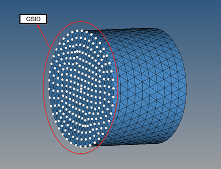

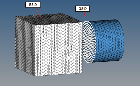

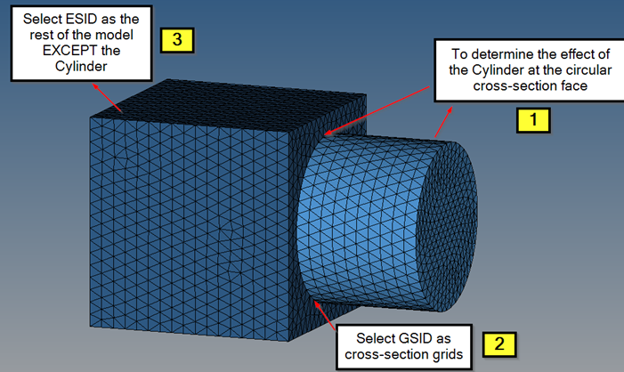

  2. The section is determined through a set of grid points and the particular face is specified by a set of elements. The face is interpreted as the side of the grid point set NOT containing the specified elements (Figure 1 through Figure 3). This is similarly applicable to RSID (rigid element set).
    Figure 1. Defining the SECTION for the RESFORCE Response
    section_resforce
    Figure 2. Selecting the GSID Set
    section_gsid
    Figure 3. Selecting the Corresponding ESID
    section_esid
