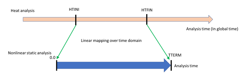

HTINI | The initial time in
HFILE/HSUB, at which the
grid temperature field is used for Nonlinear Static Analysis or
Nonlinear Transient Analysis at subcase time = 0.0. If
HTINI is not defined, the earliest time
defined in the referenced
HFILE/HSUB will be used.
The time defined in HFILE/HSUB
is global time. This can be used with HST = HFILE/HSUB only. Default = blank (Real) |
HTFIN | The final time in
grid temperature field is used for nonlinear static analysis at
subcase time = TTERM (defined in
NLPARM card). If HTFIN
is not defined, the last time defined in the referenced

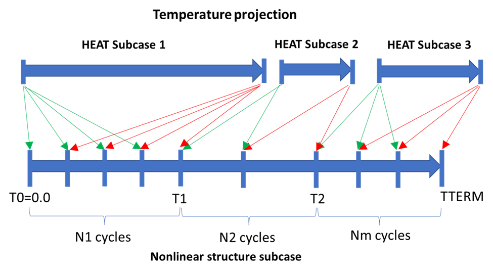

REPEAT | Identifies the number
of repeated cycles of temperature history from the specified
transient heat transfer subcase, to be applied within the
specified time period. Default = 1 (Integer) |
TEND | The end time of the
period that the thermal load is applied. This is applicable only
for HST=MHSUB. This can be omitted in the last line of the continuation lines. In this case, the end time of the nonlinear structure subcase is used. TEND values should be in ascending sequence. No default (Real) |

- The temperature field defined in
HFILE/HSUB is a linear mapping from
the time domain in between HTINI and
HTFIN to the Nonlinear Static Analysis or Nonlinear
Transient Analysis time domain.
- REPEAT can be used with HST=HFILE, HSUB, or MHSUB. When used with HST=HFILE or HSUB, the thermal loading from the HFILE or HSUB is applied N times as the value defined in the following field until the end of the nonlinear structural subcase.
- The temperature projection for HST=MHSUB
is shown below, in which T1 and T2 are the TEND values.
N1, N2, and N3 are the REPEAT values. The thermal loading
from each heat subcase is compactly applied in the time domain of the
