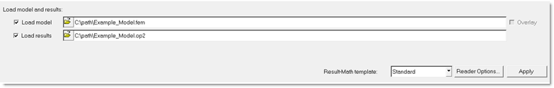

  10. Vector and Tensor plots of some element force results (weld, beam/bar and gap elements) are available for post-processing in HyperView only if the .fem file is loaded in the Load model field and the results file is loaded in the Load results field (Figure 1 is an example illustration of the HyperView Load model and results panel).
    Make sure that the Advanced option is selected from the Result Math template: menu.

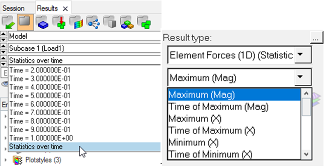

    The Element Force statistics can be viewed in HyperView after loading the H3D file, under Statistics over time option at the end of the timestep list in the Results Browser. Then, various statistics can be chosen from the sub-menu under Element Forces (1D) (Statistics) (s).
