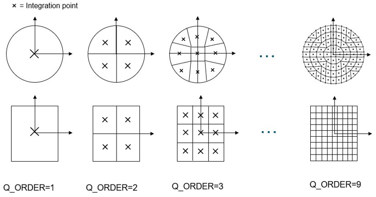

  11. The integrated beam formulation is currently available for TYPE = ROD/BAR/I sections. In this case, the beam is computed using cross-section integration. The integration points are automatically distributed in the section according to the quadrature order and the type of the section. For BAR, the number of integration points is Q_ORDER * Q_ORDER. In implicit analysis, some examples of integration point distribution in beam cross sections based on the Q_ORDER value are:
    Implicit Analysis: ROD and BAR Sections
    In implicit analysis, the number of integration point is calculated only based on Q_ORDER. By default, it is 4 for ROD, thus 16 integration points, and 5 for BAR, thus 25 integration points.
    Figure 21. Implicit Analysis ROD and BAR Section Integration Points

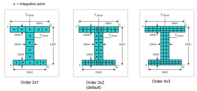

    Implicit Analysis: I Section
    In implicit analysis, the number of integration point is determined with Q_ORDER and Q_ORDER2. By default it is 2x2, thus 32 integration points.
    Figure 22. Implicit Analysis I Section Integration Points
    In explicit analysis, some examples of integration point distribution in beam cross sections based on the Q_ORDER value are:
    Explicit Analysis: ROD and BAR sections
    Figure 23. BAR Section Q_ORDER = 5 (Default)
    Figure 24. BAR Section Q_ORDER = 4
    Figure 25. ROD Section Q_ORDER = 4 (Default)
    Figure 26. ROD Section Q_ORDER = 5
    Explicit Analysis: I Section
    Sub-section definition is similar to implicit analysis. The default values for Q_ORDER and Q_ORDER2 are also the same as for implicit analysis.
    Figure 27. I Section Order 2x2 (Default)
