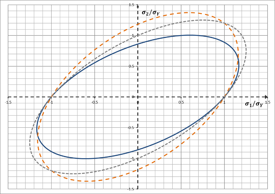

    Hill 1948 (HILL):
    The Hill yield criterion (1948) is an orthotropic version of the quadratic yield criterion which is described as:
    σ e q = 1 2 σ x x − σ y y 2 + σ y y − σ z z 2 + σ z z − σ x x 2 + 3 σ x y 2 + σ y z 2 + σ z x 2 MathType@MTEF@5@5@+= feaahGart1ev3aqatCvAUfeBSjuyZL2yd9gzLbvyNv2CaerbuLwBLn hiov2DGi1BTfMBaeXatLxBI9gBaerbd9wDYLwzYbItLDharqqtubsr 4rNCHbGeaGqiVCI8FfYJH8YrFfeuY=Hhbbf9v8qqaqFr0xc9pk0xbb a9q8WqFfeaY=biLkVcLq=JHqpepeea0=as0Fb9pgeaYRXxe9vr0=vr 0=vqpWqaaeaabiGaciaacaqabeaadaqaaqaaaOqaaabaaaaaaaaape Gaeq4Wdm3damaaBaaaleaapeGaamyzaiaadghaa8aabeaak8qacqGH 9aqpdaGcaaWdaeaapeWaaSaaa8aabaWdbiaaigdaa8aabaWdbiaaik daaaWaaeWaa8aabaWdbmaabmaapaqaa8qacqaHdpWCpaWaaSbaaSqa a8qacaWG4bGaamiEaaWdaeqaaOWdbiabgkHiTiabeo8aZ9aadaWgaa WcbaWdbiaadMhacaWG5baapaqabaaak8qacaGLOaGaayzkaaWdamaa CaaaleqabaWdbiaaikdaaaGccqGHRaWkdaqadaWdaeaapeGaeq4Wdm 3damaaBaaaleaapeGaamyEaiaadMhaa8aabeaak8qacqGHsislcqaH dpWCpaWaaSbaaSqaa8qacaWG6bGaamOEaaWdaeqaaaGcpeGaayjkai aawMcaa8aadaahaaWcbeqaa8qacaaIYaaaaOGaey4kaSYaaeWaa8aa baWdbiabeo8aZ9aadaWgaaWcbaWdbiaadQhacaWG6baapaqabaGcpe GaeyOeI0Iaeq4Wdm3damaaBaaaleaapeGaamiEaiaadIhaa8aabeaa aOWdbiaawIcacaGLPaaapaWaaWbaaSqabeaapeGaaGOmaaaaaOGaay jkaiaawMcaaiabgUcaRiaaiodadaqadaWdaeaapeGaeq4Wdm3damaa DaaaleaapeGaamiEaiaadMhaa8aabaWdbiaaikdaaaGccqGHRaWkcq aHdpWCpaWaa0baaSqaa8qacaWG5bGaamOEaaWdaeaapeGaaGOmaaaa kiabgUcaRiabeo8aZ9aadaqhaaWcbaWdbiaadQhacaWG4baapaqaa8 qacaaIYaaaaaGccaGLOaGaayzkaaaaleqaaaaa@7897@
    The equivalent stress for Hill yield criterion is obtained with:
    σ e q = F σ y y − σ z z 2 + G σ z z − σ x x 2 + H σ x x − σ y y 2 + 2 L σ y z 2 + 2 M σ z x 2 + 2 N σ x y 2 MathType@MTEF@5@5@+= feaahGart1ev3aqatCvAUfeBSjuyZL2yd9gzLbvyNv2CaerbuLwBLn hiov2DGi1BTfMBaeXatLxBI9gBaerbd9wDYLwzYbItLDharqqtubsr 4rNCHbGeaGqiVCI8FfYJH8YrFfeuY=Hhbbf9v8qqaqFr0xc9pk0xbb a9q8WqFfeaY=biLkVcLq=JHqpepeea0=as0Fb9pgeaYRXxe9vr0=vr 0=vqpWqaaeaabiGaciaacaqabeaadaqaaqaaaOqaaabaaaaaaaaape Gaeq4Wdm3damaaBaaaleaapeGaamyzaiaadghaa8aabeaak8qacqGH 9aqpdaGcaaWdaeaapeGaamOramaabmaapaqaa8qacqaHdpWCpaWaaS baaSqaa8qacaWG5bGaamyEaaWdaeqaaOWdbiabgkHiTiabeo8aZ9aa daWgaaWcbaWdbiaadQhacaWG6baapaqabaaak8qacaGLOaGaayzkaa WdamaaCaaaleqabaWdbiaaikdaaaGccqGHRaWkcaWGhbWaaeWaa8aa baWdbiabeo8aZ9aadaWgaaWcbaWdbiaadQhacaWG6baapaqabaGcpe GaeyOeI0Iaeq4Wdm3damaaBaaaleaapeGaamiEaiaadIhaa8aabeaa aOWdbiaawIcacaGLPaaapaWaaWbaaSqabeaapeGaaGOmaaaakiabgU caRiaadIeadaqadaWdaeaapeGaeq4Wdm3damaaBaaaleaapeGaamiE aiaadIhaa8aabeaak8qacqGHsislcqaHdpWCpaWaaSbaaSqaa8qaca WG5bGaamyEaaWdaeqaaaGcpeGaayjkaiaawMcaa8aadaahaaWcbeqa a8qacaaIYaaaaOGaey4kaSIaaGOmaiaadYeacqaHdpWCpaWaa0baaS qaa8qacaWG5bGaamOEaaWdaeaapeGaaGOmaaaakiabgUcaRiaaikda caWGnbGaeq4Wdm3damaaDaaaleaapeGaamOEaiaadIhaa8aabaWdbi aaikdaaaGccqGHRaWkcaaIYaGaamOtaiabeo8aZ9aadaqhaaWcbaWd biaadIhacaWG5baapaqaa8qacaaIYaaaaaqabaaaaa@79BE@
    For shell elements, the plane stress assumption implies the following equivalent stress:
    σ e q = F σ y y 2 + G σ x x 2 + H σ x x − σ y y 2 + 2 N σ x y 2 MathType@MTEF@5@5@+= feaahGart1ev3aqatCvAUfeBSjuyZL2yd9gzLbvyNv2CaerbuLwBLn hiov2DGi1BTfMBaeXatLxBI9gBaerbd9wDYLwzYbItLDharqqtubsr 4rNCHbGeaGqiVCI8FfYJH8YrFfeuY=Hhbbf9v8qqaqFr0xc9pk0xbb a9q8WqFfeaY=biLkVcLq=JHqpepeea0=as0Fb9pgeaYRXxe9vr0=vr 0=vqpWqaaeaabiGaciaacaqabeaadaqaaqaaaOqaaabaaaaaaaaape Gaeq4Wdm3damaaBaaaleaapeGaamyzaiaadghaa8aabeaak8qacqGH 9aqpdaGcaaWdaeaapeGaamOraiabeo8aZ9aadaqhaaWcbaWdbiaadM hacaWG5baapaqaa8qacaaIYaaaaOGaey4kaSIaam4raiabeo8aZ9aa daqhaaWcbaWdbiaadIhacaWG4baapaqaa8qacaaIYaaaaOGaey4kaS Iaamisamaabmaapaqaa8qacqaHdpWCpaWaaSbaaSqaa8qacaWG4bGa amiEaaWdaeqaaOWdbiabgkHiTiabeo8aZ9aadaWgaaWcbaWdbiaadM hacaWG5baapaqabaaak8qacaGLOaGaayzkaaWdamaaCaaaleqabaWd biaaikdaaaGccqGHRaWkcaaIYaGaamOtaiabeo8aZ9aadaqhaaWcba WdbiaadIhacaWG5baapaqaa8qacaaIYaaaaaqabaaaaa@5CC0@
    Where, F , G , H , L , M ,   and   N MathType@MTEF@5@5@+= feaahGart1ev3aaatCvAUfeBSjuyZL2yd9gzLbvyNv2CaerbuLwBLn hiov2DGi1BTfMBaeXatLxBI9gBaerbd9wDYLwzYbItLDharqqtubsr 4rNCHbGeaGqiVu0Je9sqqrpepC0xbbL8F4rqqrFfpeea0xe9Lq=Jc9 vqaqpepm0xbba9pwe9Q8fs0=yqaqpepae9pg0FirpepeKkFr0xfr=x fr=xb9adbaqaaeGaciGaaiaabeqaamaabaabaaGcbaGaamOraiaacY cacaWGhbGaaiilaiaadIeacaGGSaGaamitaiaacYcacaWGnbGaaiil aiaaysW7caqGHbGaaeOBaiaabsgacaaMe8UaamOtaaaa@4417@ are the Hill orthotropy coefficients.
    Some examples of the presented criterion shapes are given in Figure 1.
    Figure 1. Examples of Hill criterion shapes

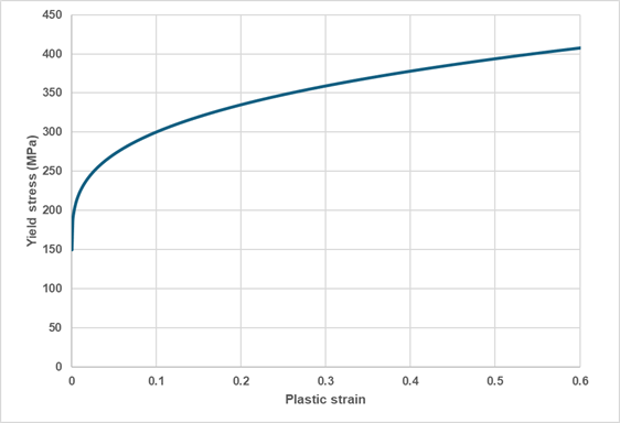

    • Johnson-Cook (JCOOK)
      The classical power law proposed by Johnson-Cook is available in PLASTIC Bulk Data Entry. This allows to describe the following hardening rule.
      σ Y = R ε p = A + B ε p n MathType@MTEF@5@5@+= feaahGart1ev3aqatCvAUfeBSjuyZL2yd9gzLbvyNv2CaerbuLwBLn hiov2DGi1BTfMBaeXatLxBI9gBaerbd9wDYLwzYbItLDharqqtubsr 4rNCHbGeaGqiVCI8FfYJH8YrFfeuY=Hhbbf9v8qqaqFr0xc9pk0xbb a9q8WqFfeaY=biLkVcLq=JHqpepeea0=as0Fb9pgeaYRXxe9vr0=vr 0=vqpWqaaeaabiGaciaacaqabeaadaqaaqaaaOqaaabaaaaaaaaape Gaeq4Wdm3damaaBaaaleaapeGaamywaaWdaeqaaOWdbiabg2da9iaa dkfadaqadaWdaeaapeGaeqyTdu2damaaBaaaleaapeGaamiCaaWdae qaaaGcpeGaayjkaiaawMcaaiabg2da9iaadgeacqGHRaWkcaWGcbGa eqyTdu2damaaDaaaleaapeGaamiCaaWdaeaapeGaamOBaaaaaaa@4726@
      Where,
      A MathType@MTEF@5@5@+= feaahGart1ev3aqatCvAUfeBSjuyZL2yd9gzLbvyNv2CaerbuLwBLn hiov2DGi1BTfMBaeXatLxBI9gBaerbd9wDYLwzYbItLDharqqtubsr 4rNCHbGeaGqiVCI8FfYJH8YrFfeuY=Hhbbf9v8qqaqFr0xc9pk0xbb a9q8WqFfeaY=biLkVcLq=JHqpepeea0=as0Fb9pgeaYRXxe9vr0=vr 0=vqpWqaaeaabiGaciaacaqabeaadaqaaqaaaOqaaabaaaaaaaaape Gaamyqaaaa@36D3@
      Initial yield stress
      B MathType@MTEF@5@5@+= feaahGart1ev3aqatCvAUfeBSjuyZL2yd9gzLbvyNv2CaerbuLwBLn hiov2DGi1BTfMBaeXatLxBI9gBaerbd9wDYLwzYbItLDharqqtubsr 4rNCHbGeaGqiVCI8FfYJH8YrFfeuY=Hhbbf9v8qqaqFr0xc9pk0xbb a9q8WqFfeaY=biLkVcLq=JHqpepeea0=as0Fb9pgeaYRXxe9vr0=vr 0=vqpWqaaeaabiGaciaacaqabeaadaqaaqaaaOqaaabaaaaaaaaape Gaamyqaaaa@36D3@
      Hardening modulus
      n MathType@MTEF@5@5@+= feaahGart1ev3aqatCvAUfeBSjuyZL2yd9gzLbvyNv2CaerbuLwBLn hiov2DGi1BTfMBaeXatLxBI9gBaerbd9wDYLwzYbItLDharqqtubsr 4rNCHbGeaGqiVCI8FfYJH8YrFfeuY=Hhbbf9v8qqaqFr0xc9pk0xbb a9q8WqFfeaY=biLkVcLq=JHqpepeea0=as0Fb9pgeaYRXxe9vr0=vr 0=vqpWqaaeaabiGaciaacaqabeaadaqaaqaaaSqaaabaaaaaaaaape GaamOBaaaa@3701@
      Hardening exponent
      Figure 2. Johnson-Cook hardening rule shape example

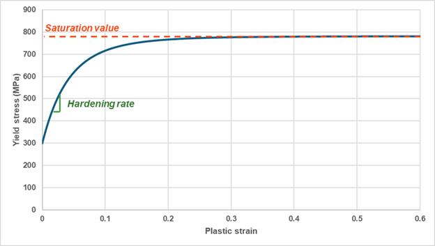

    • Voce 3 terms (VOCE)
      Saturation work hardening law can also be used in PLASTIC with Voce formula, restricted to a maximum of 3 exponential terms in OptiStruct. It is described with:
      σ Y = R ε p = R 0 + ∑ i = 1 3 Q i 1 − exp − b i ε p MathType@MTEF@5@5@+= feaahGart1ev3aqatCvAUfeBSjuyZL2yd9gzLbvyNv2CaerbuLwBLn hiov2DGi1BTfMBaeXatLxBI9gBaerbd9wDYLwzYbItLDharqqtubsr 4rNCHbGeaGqiVCI8FfYJH8YrFfeuY=Hhbbf9v8qqaqFr0xc9pk0xbb a9q8WqFfeaY=biLkVcLq=JHqpepeea0=as0Fb9pgeaYRXxe9vr0=vr 0=vqpWqaaeaabiGaciaacaqabeaadaqaaqaaaOqaaabaaaaaaaaape Gaeq4Wdm3damaaBaaaleaapeGaamywaaWdaeqaaOWdbiabg2da9iaa dkfadaqadaWdaeaapeGaeqyTdu2damaaBaaaleaapeGaamiCaaWdae qaaaGcpeGaayjkaiaawMcaaiabg2da9iaadkfapaWaaSbaaSqaa8qa caaIWaaapaqabaGcpeGaey4kaSYaaubmaeqal8aabaWdbiaadMgacq GH9aqpcaaIXaaapaqaa8qacaaIZaaan8aabaWdbiabggHiLdaakiaa dgfapaWaaSbaaSqaa8qacaWGPbaapaqabaGcpeWaaeWaa8aabaWdbi aaigdacqGHsislciGGLbGaaiiEaiaacchadaqadaWdaeaapeGaeyOe I0IaamOya8aadaWgaaWcbaWdbiaadMgaa8aabeaak8qacqaH1oqzpa WaaSbaaSqaa8qacaWGWbaapaqabaaak8qacaGLOaGaayzkaaaacaGL OaGaayzkaaaaaa@59D1@
      Where,
      R 0 MathType@MTEF@5@5@+= feaahGart1ev3aqatCvAUfeBSjuyZL2yd9gzLbvyNv2CaerbuLwBLn hiov2DGi1BTfMBaeXatLxBI9gBaerbd9wDYLwzYbItLDharqqtubsr 4rNCHbGeaGqiVCI8FfYJH8YrFfeuY=Hhbbf9v8qqaqFr0xc9pk0xbb a9q8WqFfeaY=biLkVcLq=JHqpepeea0=as0Fb9pgeaYRXxe9vr0=vr 0=vqpWqaaeaabiGaciaacaqabeaadaqaaqaaaOqaaabaaaaaaaaape GaamOua8aadaWgaaWcbaWdbiaaicdaa8aabeaaaaa@37F8@
      Q MathType@MTEF@5@5@+= feaahGart1ev3aqatCvAUfeBSjuyZL2yd9gzLbvyNv2CaerbuLwBLn hiov2DGi1BTfMBaeXatLxBI9gBaerbd9wDYLwzYbItLDharqqtubsr 4rNCHbGeaGqiVCI8FfYJH8YrFfeuY=Hhbbf9v8qqaqFr0xc9pk0xbb a9q8WqFfeaY=biLkVcLq=JHqpepeea0=as0Fb9pgeaYRXxe9vr0=vr 0=vqpWqaaeaabiGaciaacaqabeaadaqaaqaaaOqaaabaaaaaaaaape Gaamyuaaaa@36E3@
      Saturation moduli
      b MathType@MTEF@5@5@+= feaahGart1ev3aqatCvAUfeBSjuyZL2yd9gzLbvyNv2CaerbuLwBLn hiov2DGi1BTfMBaeXatLxBI9gBaerbd9wDYLwzYbItLDharqqtubsr 4rNCHbGeaGqiVCI8FfYJH8YrFfeuY=Hhbbf9v8qqaqFr0xc9pk0xbb a9q8WqFfeaY=biLkVcLq=JHqpepeea0=as0Fb9pgeaYRXxe9vr0=vr 0=vqpWqaaeaabiGaciaacaqabeaadaqaaqaaaOqaaabaaaaaaaaape GaamOyaaaa@36F4@
      Hardening saturation rates
      Note: When ε p → ∞ MathType@MTEF@5@5@+= feaahGart1ev3aqatCvAUfeBSjuyZL2yd9gzLbvyNv2CaerbuLwBLn hiov2DGi1BTfMBaeXatLxBI9gBaerbd9wDYLwzYbItLDharqqtubsr 4rNCHbGeaGqiVCI8FfYJH8YrFfeuY=Hhbbf9v8qqaqFr0xc9pk0xbb a9q8WqFfeaY=biLkVcLq=JHqpepeea0=as0Fb9pgeaYRXxe9vr0=vr 0=vqpWqaaeaabiGaciaacaqabeaadaqaaqaaaOqaaabaaaaaaaaape GaeqyTdu2damaaBaaaleaapeGaamiCaaWdaeqaaOWdbiabgkziUkab g6HiLcaa@3C7B@ , the yield stress reaches a saturation value which equals to:
      R = ∑ i = 1 3 Q i MathType@MTEF@5@5@+= feaahGart1ev3aqatCvAUfeBSjuyZL2yd9gzLbvyNv2CaerbuLwBLn hiov2DGi1BTfMBaeXatLxBI9gBaerbd9wDYLwzYbItLDharqqtubsr 4rNCHbGeaGqiVCI8FfYJH8YrFfeuY=Hhbbf9v8qqaqFr0xc9pk0xbb a9q8WqFfeaY=biLkVcLq=JHqpepeea0=as0Fb9pgeaYRXxe9vr0=vr 0=vqpWqaaeaabiGaciaacaqabeaadaqaaqaaaOqaaabaaaaaaaaape GaamOuaiabg2da9maavadabeWcpaqaa8qacaWGPbGaeyypa0JaaGym aaWdaeaapeGaaG4maaqdpaqaa8qacqGHris5aaGccaWGrbWdamaaBa aaleaapeGaamyAaaWdaeqaaaaa@3FE4@
      Figure 3. Voce 3 terms hardening rule shape example

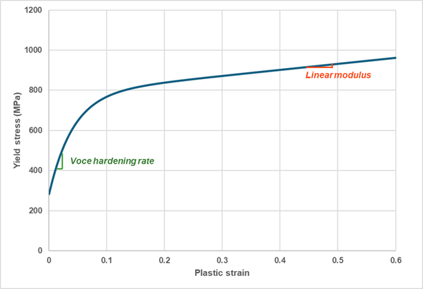

    • Linear/Voce combination (LINVOC)
      With PLASTIC it is also possible to combine the effect of linear hardening and saturation Voce law allowing to control the slope of the yield stress increase after saturation. This is available with the keyword LINVOC which describes the following hardening rule:
      σ Y = R ε p = R 0 + H ε p + Q 1 − exp − b ε p MathType@MTEF@5@5@+= feaahGart1ev3aqatCvAUfeBSjuyZL2yd9gzLbvyNv2CaerbuLwBLn hiov2DGi1BTfMBaeXatLxBI9gBaerbd9wDYLwzYbItLDharqqtubsr 4rNCHbGeaGqiVCI8FfYJH8YrFfeuY=Hhbbf9v8qqaqFr0xc9pk0xbb a9q8WqFfeaY=biLkVcLq=JHqpepeea0=as0Fb9pgeaYRXxe9vr0=vr 0=vqpWqaaeaabiGaciaacaqabeaadaqaaqaaaOqaaabaaaaaaaaape Gaeq4Wdm3damaaBaaaleaapeGaamywaaWdaeqaaOWdbiabg2da9iaa dkfadaqadaWdaeaapeGaeqyTdu2damaaBaaaleaapeGaamiCaaWdae qaaaGcpeGaayjkaiaawMcaaiabg2da9iaadkfapaWaaSbaaSqaa8qa caaIWaaapaqabaGcpeGaey4kaSIaamisaiabew7aL9aadaWgaaWcba Wdbiaadchaa8aabeaak8qacqGHRaWkcaWGrbWaaeWaa8aabaWdbiaa igdacqGHsislciGGLbGaaiiEaiaacchadaqadaWdaeaapeGaeyOeI0 IaamOyaiabew7aL9aadaWgaaWcbaWdbiaadchaa8aabeaaaOWdbiaa wIcacaGLPaaaaiaawIcacaGLPaaaaaa@55F0@
      Where,
      H MathType@MTEF@5@5@+= feaahGart1ev3aqatCvAUfeBSjuyZL2yd9gzLbvyNv2CaerbuLwBLn hiov2DGi1BTfMBaeXatLxBI9gBaerbd9wDYLwzYbItLDharqqtubsr 4rNCHbGeaGqiVCI8FfYJH8YrFfeuY=Hhbbf9v8qqaqFr0xc9pk0xbb a9q8WqFfeaY=biLkVcLq=JHqpepeea0=as0Fb9pgeaYRXxe9vr0=vr 0=vqpWqaaeaabiGaciaacaqabeaadaqaaqaaaOqaaabaaaaaaaaape Gaamisaaaa@36DA@
      Linear modulus
      Saturation moduli
      Hardening rate parameter
    Figure 4. Linear-Voce hardening rule shape example

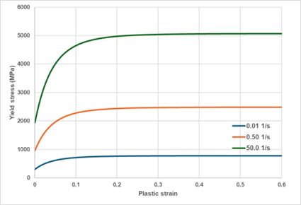

      The Johnson-Cook strain rate dependency is a well-known solution to add strain rate dependency to an elasto-plastic behavior. The hardening rule is then multiplied by:
      σ Y = R ε p 1 + C ln 1 + ε ˙ ε ˙ 0 MathType@MTEF@5@5@+= feaahGart1ev3aqatCvAUfeBSjuyZL2yd9gzLbvyNv2CaerbuLwBLn hiov2DGi1BTfMBaeXatLxBI9gBaerbd9wDYLwzYbItLDharqqtubsr 4rNCHbGeaGqiVCI8FfYJH8YrFfeuY=Hhbbf9v8qqaqFr0xc9pk0xbb a9q8WqFfeaY=biLkVcLq=JHqpepeea0=as0Fb9pgeaYRXxe9vr0=vr 0=vqpWqaaeaabiGaciaacaqabeaadaqaaqaaaOqaaabaaaaaaaaape Gaeq4Wdm3damaaBaaaleaapeGaamywaaWdaeqaaOWdbiabg2da9iaa dkfadaqadaWdaeaapeGaeqyTdu2damaaBaaaleaapeGaamiCaaWdae qaaaGcpeGaayjkaiaawMcaamaabmaapaqaa8qacaaIXaGaey4kaSIa am4qaiGacYgacaGGUbWaaeWaa8aabaWdbiaaigdacqGHRaWkdaWcaa WdaeaapeGafqyTdu2dayaacaaabaWdbiqbew7aL9aagaGaamaaBaaa leaapeGaaGimaaWdaeqaaaaaaOWdbiaawIcacaGLPaaaaiaawIcaca GLPaaaaaa@4DC9@
      Where,
      C MathType@MTEF@5@5@+= feaahGart1ev3aqatCvAUfeBSjuyZL2yd9gzLbvyNv2CaerbuLwBLn hiov2DGi1BTfMBaeXatLxBI9gBaerbd9wDYLwzYbItLDharqqtubsr 4rNCHbGeaGqiVCI8FfYJH8YrFfeuY=Hhbbf9v8qqaqFr0xc9pk0xbb a9q8WqFfeaY=biLkVcLq=JHqpepeea0=as0Fb9pgeaYRXxe9vr0=vr 0=vqpWqaaeaabiGaciaacaqabeaadaqaaqaaaOqaaabaaaaaaaaape Gaam4qaaaa@36D5@
      Johnson-Cook parameter
      ε ˙ 0
      Reference strain rate delimiting the transition between the inviscid domain and the strain rate dependent domain
      The Johnson-Cook model thus describes a linear increase of the material strength with respect to the logarithm of the strain rate. (Figure 5). An example of yield stress increase shape obtained with the presented model is given in Figure 6.
      Figure 5. Johnson-Cook strain rate dependency model
      Figure 6. Johnson-Cook stress rate dependency model

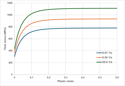

    • Cowper-Symonds (COWPER)
      The Cowper-Symonds rate dependency is another solution commonly found in the literature. It modifies the yield stress equation a:
      σ Y = R ε p 1 + ε ˙ c 1 p MathType@MTEF@5@5@+= feaahGart1ev3aqatCvAUfeBSjuyZL2yd9gzLbvyNv2CaerbuLwBLn hiov2DGi1BTfMBaeXatLxBI9gBaerbd9wDYLwzYbItLDharqqtubsr 4rNCHbGeaGqiVCI8FfYJH8YrFfeuY=Hhbbf9v8qqaqFr0xc9pk0xbb a9q8WqFfeaY=biLkVcLq=JHqpepeea0=as0Fb9pgeaYRXxe9vr0=vr 0=vqpWqaaeaabiGaciaacaqabeaadaqaaqaaaOqaaabaaaaaaaaape Gaeq4Wdm3damaaBaaaleaapeGaamywaaWdaeqaaOWdbiabg2da9iaa dkfadaqadaWdaeaapeGaeqyTdu2damaaBaaaleaapeGaamiCaaWdae qaaaGcpeGaayjkaiaawMcaamaabmaapaqaa8qacaaIXaGaey4kaSYa aeWaa8aabaWdbmaalaaapaqaa8qacuaH1oqzpaGbaiaaaeaapeGaam 4yaaaaaiaawIcacaGLPaaapaWaaWbaaSqabeaapeWaaSaaa8aabaWd biaaigdaa8aabaWdbiaadchaaaaaaaGccaGLOaGaayzkaaaaaa@49DE@
      Where,
      c MathType@MTEF@5@5@+= feaahGart1ev3aqatCvAUfeBSjuyZL2yd9gzLbvyNv2CaerbuLwBLn hiov2DGi1BTfMBaeXatLxBI9gBaerbd9wDYLwzYbItLDharqqtubsr 4rNCHbGeaGqiVCI8FfYJH8YrFfeuY=Hhbbf9v8qqaqFr0xc9pk0xbb a9q8WqFfeaY=biLkVcLq=JHqpepeea0=as0Fb9pgeaYRXxe9vr0=vr 0=vqpWqaaeaabiGaciaacaqabeaadaqaaqaaaOqaaabaaaaaaaaape Gaam4yaaaa@36F5@
      Strain rate dependency parameter
      p MathType@MTEF@5@5@+= feaahGart1ev3aqatCvAUfeBSjuyZL2yd9gzLbvyNv2CaerbuLwBLn hiov2DGi1BTfMBaeXatLxBI9gBaerbd9wDYLwzYbItLDharqqtubsr 4rNCHbGeaGqiVCI8FfYJH8YrFfeuY=Hhbbf9v8qqaqFr0xc9pk0xbb a9q8WqFfeaY=biLkVcLq=JHqpepeea0=as0Fb9pgeaYRXxe9vr0=vr 0=vqpWqaaeaabiGaciaacaqabeaadaqaaqaaaOqaaabaaaaaaaaape Gaam4yaaaa@36F5@
      Strain rate exponent parameter
      The shape of the presented model is given in Figure 7.
      Figure 7. Cowper-Symonds strain rate dependency model
      Figure 8. Cowper-Symonds stress rate dependency model

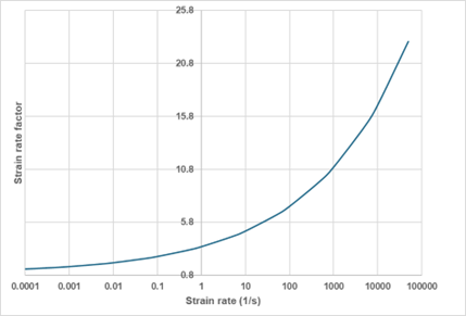

    • Nonlinear (NLINEAR)
      The nonlinear strain rate dependency is similar to the Johnson-Cook model described above. Nevertheless, it describes a nonlinear evolution of the strain rate dependency in the logarithmic scale (Figure 9). This is introduced in the yield stress formula as:
      σ Y = R ε p 1 + ε ˙ ε ˙ 0 C S MathType@MTEF@5@5@+= feaahGart1ev3aqatCvAUfeBSjuyZL2yd9gzLbvyNv2CaerbuLwBLn hiov2DGi1BTfMBaeXatLxBI9gBaerbd9wDYLwzYbItLDharqqtubsr 4rNCHbGeaGqiVCI8FfYJH8YrFfeuY=Hhbbf9v8qqaqFr0xc9pk0xbb a9q8WqFfeaY=biLkVcLq=JHqpepeea0=as0Fb9pgeaYRXxe9vr0=vr 0=vqpWqaaeaabiGaciaacaqabeaadaqaaqaaaOqaaabaaaaaaaaape Gaeq4Wdm3damaaBaaaleaapeGaamywaaWdaeqaaOWdbiabg2da9iaa dkfadaqadaWdaeaapeGaeqyTdu2damaaBaaaleaapeGaamiCaaWdae qaaaGcpeGaayjkaiaawMcaamaabmaapaqaa8qacaaIXaGaey4kaSYa aSaaa8aabaWdbiqbew7aL9aagaGaaaqaa8qacuaH1oqzpaGbaiaada WgaaWcbaWdbiaaicdaa8aabeaaaaaak8qacaGLOaGaayzkaaWdamaa CaaaleqabaWdbiaadoeacaWGtbaaaaaa@49C4@
      Where,
      C S MathType@MTEF@5@5@+= feaahGart1ev3aqatCvAUfeBSjuyZL2yd9gzLbvyNv2CaerbuLwBLn hiov2DGi1BTfMBaeXatLxBI9gBaerbd9wDYLwzYbItLDharqqtubsr 4rNCHbGeaGqiVCI8FfYJH8YrFfeuY=Hhbbf9v8qqaqFr0xc9pk0xbb a9q8WqFfeaY=biLkVcLq=JHqpepeea0=as0Fb9pgeaYRXxe9vr0=vr 0=vqpWqaaeaabiGaciaacaqabeaadaqaaqaaaSqaaabaaaaaaaaape Gaam4qaiaadofaaaa@37AE@
      Strain rate dependency exponent
      ε ˙ 0

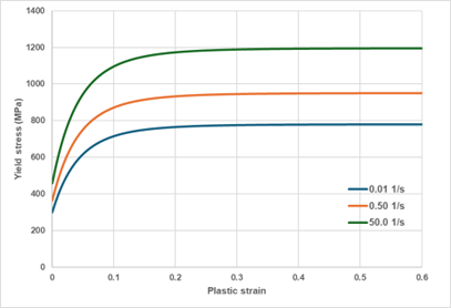

      An example of the presented model on the yield stress shape is given in Figure 10.
      Figure 9. Nonlinear strain rate dependency model
      Figure 10. Nonlinear stress rate dependency model
