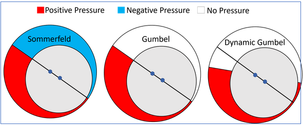

The Dynamic Gumbel method considers the continuous variation of the location
where the positive pressure exists each time step. Thus, it provides better
results in a transient state, but is computationally more expensive. For example,
in the picture below, the region of positive pressure is not aligned with the
line that connects the two centers as in the Gumbel method.
Use the lubrication_force_graphics attribute for a better understanding of the
pressure distribution along the journal bearing. The force vectors represent the
pressure that acts at the journal.
