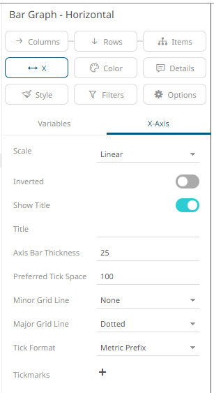

Other visualization-specific properties can be set by clicking on either:
- Y-Axis variable drop area then selecting the Y-Axis tab (for Vertical Bar Graphs) or
- X-Axis variable drop area then selecting the X-Axis tab (for Horizontal Bar Graphs)
