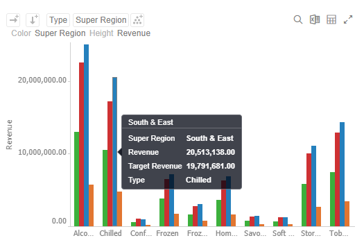

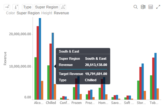

The Details variable controls the information that appears on the pop-up when hovering over a specific item within a visualization. It also controls the information available for export from the visualization.

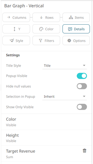

- Click the Details button of a visualization. The Details Settings pane displays along with the available variables of the visualization.

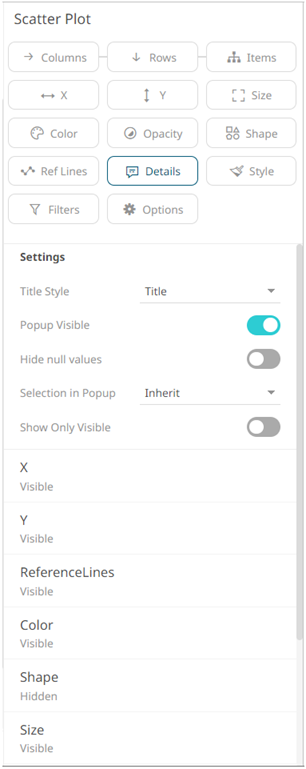

Sample 1: Scatter Plot visualization has HeightX, HeightY, Size, Color,Opacity, Shape, and Reference Lines variables.

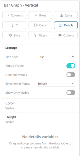

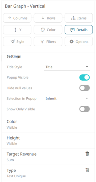

Sample 2: Bar Graph – Vertical visualization has HeightY and Color variables.

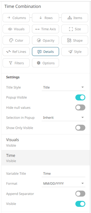

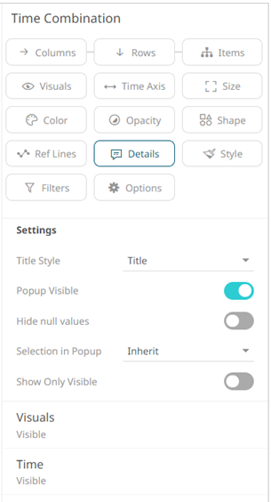

Sample 3: Time Combination visualization has Visuals and Time variables.

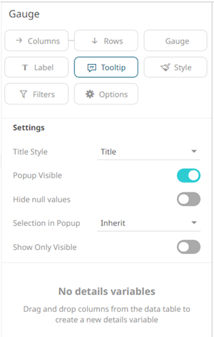

Sample 4: Gauge visualization has the Tooltip variable.
- Select the Title Style: Title, Visible Path, or Full Path.

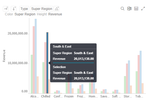

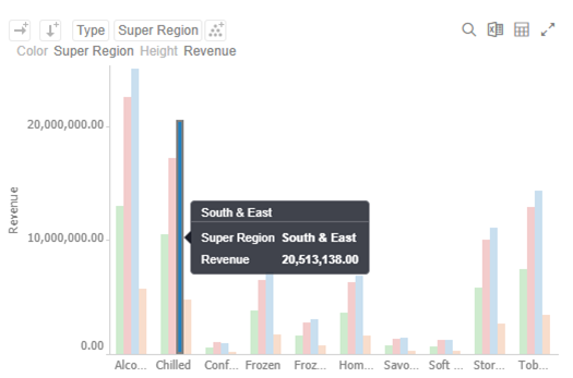

- By default, Popup Visible is enabled to display the Details pop-up. Tap the slider to turn it off.
- Tap the Hide Null Values slider to turn it on.
- Select the Selection in Popup:
- On
The Details pop-up of the selection in the visualization are displayed.
- Off
The selection in the Details pop-up is turned off.
- Inherit
The selection option in the Details pop-up is inherited from the workbook properties.
- On
- Tap the Show Only Visible slider to turn it on. This means that only the variables that are marked as visible in the tooltip or graph will be displayed in the list.

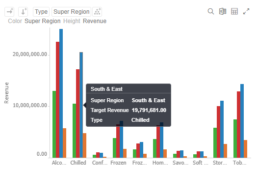

- You can also drag and drop numeric columns from the Data Table pane to the Details
button or on the Details pane.
The column is added under the Details pane.

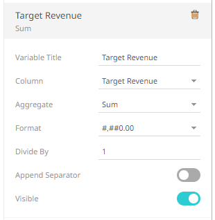

- Click on the column to display the configuration pane.
- Enter the label of the Details variable in the Variable Title field.
You can parameterize the variable title to support dynamic schema in the dashboards.
- You can opt to change the column to the be used from the Column drop-down list.
- Specify an aggregation method in the Aggregate field.
The default is Sum.
The Details variable also supports several other aggregate types:
- If you set the aggregation method to Cumulative Sum or Cumulative Sum by Max, the Sort By drop-down list is enabled and displays a list of numeric data columns in the selected data table that can be used as the sorting column for the aggregate.
Cumulative Sum By Max is, in practice, Cumulative Sum with a setting to use Max as he sort by aggregation.
- If you set the aggregation method to Intercept or Slope, the Y Variable drop-down list is enabled and displays a list of numeric data columns in the selected data table that can be used as the Y-axis variable column for the aggregate.
- If you set the aggregation method to Percent of Parent Reference, Percent of Total Reference, or Ratio of Sums, the Reference Column drop-down list is enabled and displays a list of numeric data columns in the selected data table that can be used as the reference column for the aggregate.
- If you set the aggregation method to Percent of Total Change, the Previous Values Column drop-down list is enabled and displays a list of numeric data columns in the selected data table that can be used as the previous column for the aggregate.
- If you set the aggregation method to Percentile, the Percentile field is displayed. Specify the value that can be used to calculate the value of the selected percentile.
- If you set the aggregation method to Weighted Harmonic Mean, Weighted Mean, Weighted Population Variance, Weighted Stdev, Weighted Stdevp, Weighted Sum, or Weighted Variance, the Weight Column drop-down list is enabled and displays a list of numeric data columns in the selected data table that can be used as the weight column for the aggregate.
- The Format field lets you specify the format that numbers will be displayed in. Panopticon uses the same formatting rules as Excel.
- Select the Divide By value to divide a number:
- 1
- 1000 (by a thousand)
- 10000
- 1000000 (by a million)
- 1000000000 (by a billion)

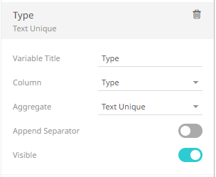

- You can also drag and drop text columns from the Data Table pane to the Details
- You can also change the column to the be used from the Column drop-down list.
- Select the text aggregation method from the Aggregate field: Count Distinct, Text Unique (default), or Text Concat Distinct.
- The Format field lets you specify the format that the text will be displayed in. Panopticon uses the same formatting rules as Excel.

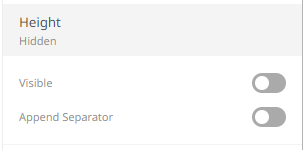

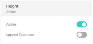

- By default, all of the variables are set to be Visible on the Details pop-up.
For example, when the Height variable column is Revenue and set to Visible, the value of Revenue is displayed in the Details pop-up.
Tap the Visible slider to turn it off so the variable detail will not be displayed.
- Tap the Append Separator slider to display the separator of the values.

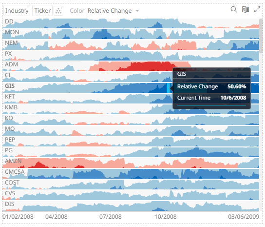

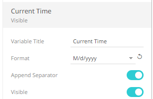

- For time series visualizations, you can set the current time period that will be displayed on the Details pop-up. Otherwise, skip to step 23.
Set the Variable Title and the Format. For example:
