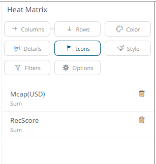

- To associate columns from the data table, drag and drop them to the Icons variable drop area. Select a numeric column to display the corresponding configuration pane.
This displays the configuration pane.

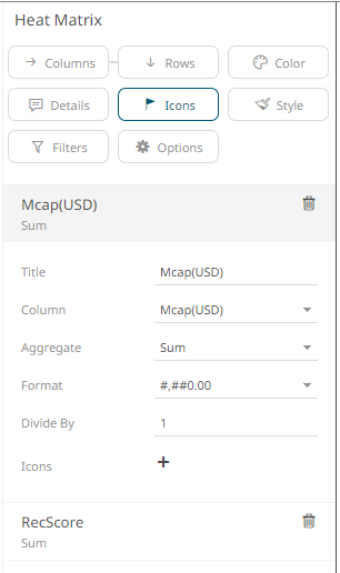

- Enter the label of the Icons variable in the Variable Title field.
- You can also change the column to be used as the Icons variable from the Column drop-down list.
- Specify an aggregation method in the Aggregate field.
The default is Sum.
The Icons variable also supports several other aggregate types:

- The Format field lets you specify the format that numbers will be displayed in. Panopticon uses the same formatting rules as Excel.
- Select the Divide By value to divide a number:
- 1
- 1000 (by a thousand)
- 10000
- 1000000 (by a million)
- 1000000000 (by a billion)
- Click the Add Icon
button to complete the task.
Clicking the Add Icon button with a numeric column displays a new section where you can specify:
- Enter the Label of the new icon.
- Specify the numeric range (Min and Max) to display the icon. Leaving the Min and Max fields empty implies no limit.
- Select the Icon from the drop-down list.

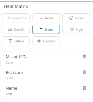

- To associate columns from the data table, drag and drop them to the Icons variable drop area. Select a text column to display the corresponding configuration pane.
