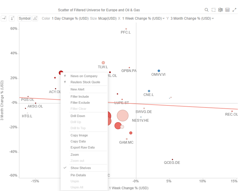

Actions allow Panopticon workbooks to be more interactive:
- Link information in dashboards to external systems
- Use Navigation Actions to pre-filter dashboards
- Open web pages contextually through URL Actions
- Execute JavaScript functions in context using Script Actions
Actions use parameters to pass selected text values to external applications, to JavaScript functions and to other dashboards.
All methods provide the ability to view a summary data set, select particular items of interest and then jump to another data set focused on these particular items. This focused data set may be presented through another tab within the workbook (Navigation Action) or through an external system (URL Actions & Script Actions).
Actions are exposed to the user through the right-click context menu, with the Action icon to the left of the Action name.
