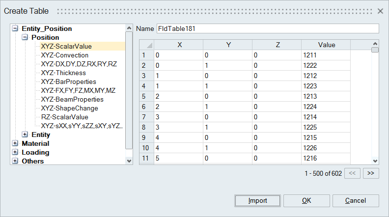

- Table Type: Left side panel will list all the table type supported and it will depend on the source from where this dialog is launched. For Example: Pressure supports (XYZ Vs value) or (Frequency/Time Vs value) and Material's Youngs Modulus field will support (Stress,Strain,Temperature) input.
- When users enter the data in the last row last column, a new row will be created automatically.

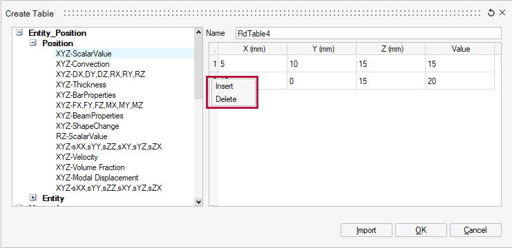

- User can also add or delete the row from the table by “Right click on Table row
header > Insert/Delete” options.

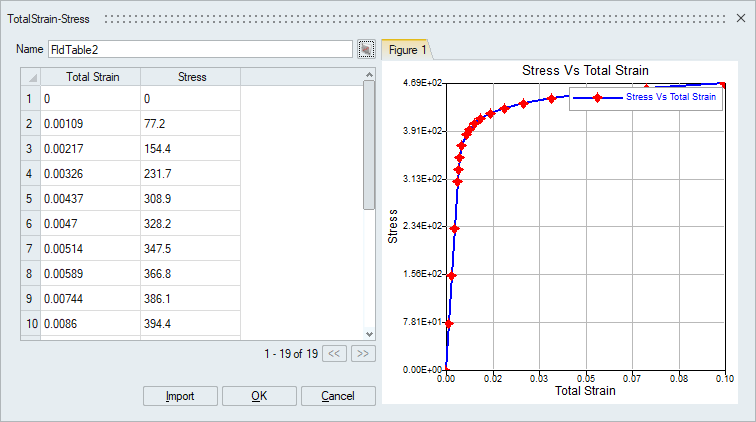

- Users can import their field data from the .csv, .dat or .txt files and the same can be exported as (*.csv / *.dat) file by using "Export" option in table right click menu.
- For spatially varying tables (Ex: X, Y, Z - Force Components), users can plot the Contour in table right click menu.
- Users can visualize their tabular data in 2D graph using the Plot Graph option in the table dialog. Note: The Preference | Result - "Enable new graphing tool" should be turned ON to enable this option.
