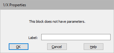

Block Category: Arithmetic
Inputs: Real or complex scalars, vectors, or matrices.
Description: The 1/X block generates the inverse of the input signal. If a vector or matrix is fed into a 1/X block, the result is an element-by-element inversion of the vector or matrix (that is, [one divided by the element] operation). This is not equivalent to a normal vector pseudo-inverse operation or a normal matrix inverse operation.
Use the invert block to compute the matrix inverse of a matrix.
