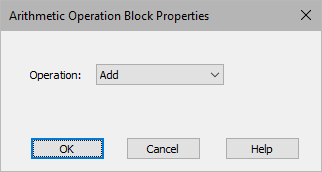

Operation: Specifies the operation to be performed on the input images.
In this example, the results of an Add operation is displayed.
