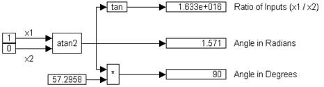

1. Computation of tan-1(∝) = π/2
This equation is realized as:
To convert radians to degrees, the angle in radians is multiplied by (180/π) = 57.2958.
Since the atan2 block uses the value of x1, the signs of x1 and x2, and the ratio x1/x2 in computing the inverse tangent, the result depends on all these parameters. In the current case, since the ratio is infinity, atan2 computes the inverse correctly to be π/2 radians, or 90o. Also, in the current case, x1 can be any positive value, since its ratio with 0 will be infinity, regardless of its value.

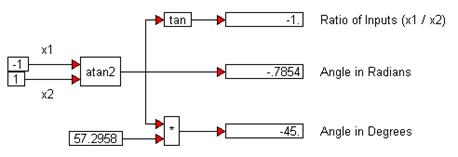

2. Computation of tan-1(-1): quadrant dependency
Using the same configuration in the above example, tan-1(-1) is realized as:
Here, the angle obtained is -0.7854 radians, or -45o, because the atan2 block determines that the angle lies in the fourth quadrant. However, it is immediately apparent that the same ratio of -1 can be obtained by flipping the signs on x1 and x2:
In this case, the atan2 block uses the relative signs of x1 and x2 to determine that the angle lies in the second quadrant, and yields an angle of 180 - 45 = 135o, or 2.356 radians.
