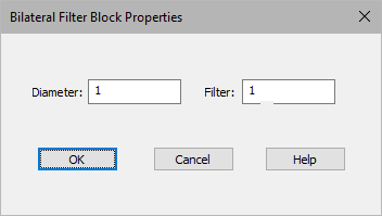

Diameter: Specifies the diameter of the pixel neighborhood used during filtering. The value must be less than 30.
Filter: Determines the range of pixel values such that pixel value x will be replaced with similar pixel values. This results in large areas of semi-equal pixel values. The larger the filter value, the stronger the effect on the image, which makes the image appear smoother and more cartoonish.
