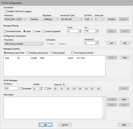

Description: CAN Peak Config sets the baud rate and message type.
Additional Information: To determine the correct settings for these parameters, refer to the device vendor documentation.
Configuration Parameters: Lets you select and set USB configuration parameters.
Connection
Enable CAN Event Logging: Enable CAN events, like bus error light and bus error heavy
Hardware: Once your CAN driver is successfully installed and the device is plugged in, select PCAN_USB.
Baud Rate: Specifies the baud rate. You must match the baud rate to the CAN bus.
Hardware Type, I/O Port, Interrupt: Not applicable.
Message Filtering: Specifies filter configuration for standard or extended frames.
Message Reading: Controls how messages are received.
Message Writing: Controls how messages are sent.
