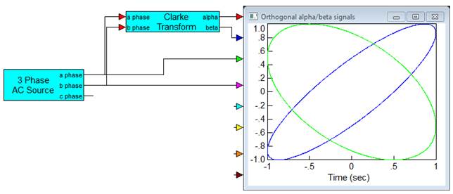

The following simulation shows the transformation and compares the phase differences as a Lissajous figure.
