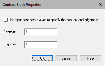

Contrast / Brightness: Together, these values control the contrast and brightness value of every pixel in the image. Specify the values as integers between 0 and 100. If Use input connector values is activated, these values come from the contrast and brightness input connectors.
Use input connector values to specify the contrast and brightness: Adds two input connectors to the block to control the contrast and brightness. Acceptable values are integers between 0 and 100.

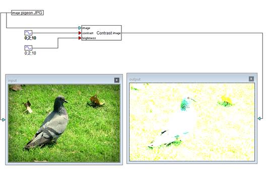

In this example, the image’s contrast and brightness are controlled by two sine waves that oscillate the image from a lighter and brighter to darker and duller.
