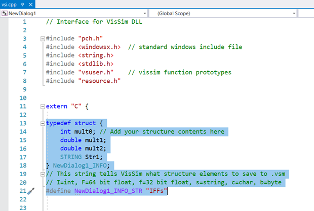

3. Add a second floating point double to the structure at line 16. Note that NewDialog1_INFO_STR changes from IFs to IFFs at line 21.
To properly save and restore block parameter values, a text string is encoded with data types of structure elements in an Info String macro. Each character of the string corresponds to a data type. Any changes to the block parameter structure requires corresponding changes to Info String. Info String tells Embed what block data must be saved in the VSM file. The Embed DLL wizard adds a brief description string:
// This string tells VisSim what structure elements to save to .vsm
// I=int, F=64 bit float, f=32 bit float, s=string, c=char, b=byt
Good practice: The data structure can contain non-persistent data that can be used for block execution but does not need to be saved in the VSM file. In this case, the block data structure must have all persistent data on the top with matching Info String. Nonpersistent data should be at the bottom of the block data structure past the Info String entries so that needless transient data is not saved to the VSM file.

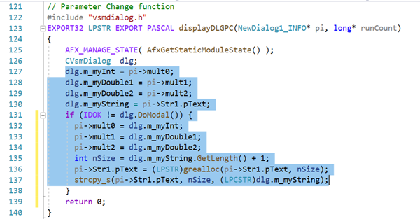

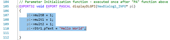

5. Within the file, the functionnamePI function initializes the block parameters (displayDLGPI).Using this function, initialize the block parameters with default values for the dialog, as shown in the highlighted text below:
6. The basefunctionnamePC function displays and allows editing of block parameters in the dialog (displayDLGPC). In this function, the MFC dialog object dlg in line 126 is instantiated and block parameter values are assigned to dlg object members, as shown in the highlighted text below:

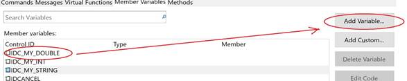

7. The CVsmDialog class is defined in VSMDIALOG.H and contains dialog member elements. To add or change elements, invoke the Class Wizard from Visual Studio Project > Class Wizard (CTRL+SHIFT+ X) .
8. Select the dialog class name.
9. Switch to the Member Variables tab.
10. For required Control IDs, add dialog class variables.
11. In simple cases, the variable category should be Value. Enter the desired variable type and variable name.

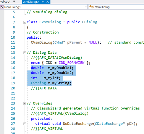

13. Alternatively, you can declare the variables in VSMDIALOG.H, as highlighted in the text below:

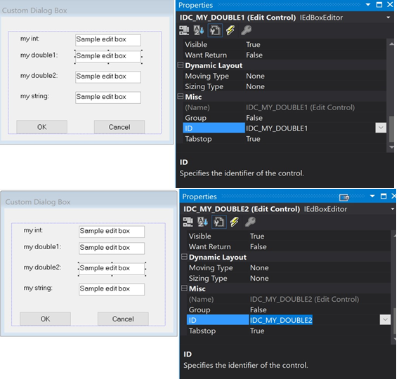

14. Make sure you map your variables to the correct IDs.
a. Double-click NEWDIALOG1.RC to see the sample dialog.
b. Click on any input form (example – edit box)
c. Verify or change the ID value under the Properties browser.

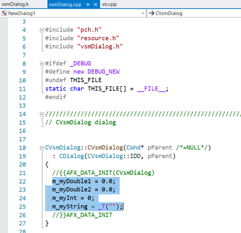

15. The declared variables for the dialog in VSMDIALOG.H can be defined in VSMDIALOG.CPP under the public CVsmDialog class.

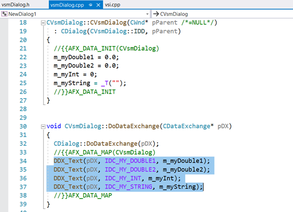

16. Data exchange between dialog and defined variables is ensured with the DDX_Text() function, which lists all variables and their ID values within VSMDIALOG.CPP, as highlighted in the text below:

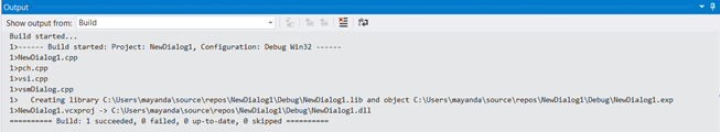

17. A clean build of the DLL file is shown below:
