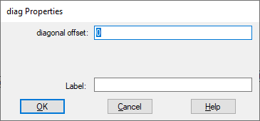

Diagonal Offset: Indicates the offset from the main diagonal. The default is 0, which puts vector V on the main diagonal.

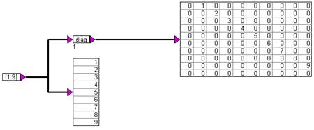

The diag block generates a 10-by-10 matrix. The 9-element vector is placed on the diagonal with an offset of 1. The remaining cells are padded with 0s.
