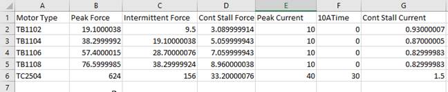

When you attach a data table to a dialogTable block, Embed arranges and presents the information from the data lists in the dialogTable dialog. For example, consider the following data table for five motors:

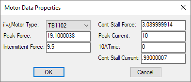

When you attach the data table to the dialogTable block, the resulting dialogTable dialog looks like this:
Here, the TB1102 motor type shows the corresponding Peak Force, Intermittent Force, Cont Stall Force, Peak Current, 10A Time, and Cont Stall Current contained in the data table. If you select a new motor type, Embed updates the dialog with data corresponding to that motor type.

2. In the first row of cells, enter the field names for the data table. These field names are the header record.
Note that the information in cell A1 must be the item identifier. In the above example, Motor Type is the item identifier.
3. Beginning in the first cell of the second row, enter the information that corresponds to the field name at the top of the column. Press tab to move to the next cell.
4. When you have finished entering all the data records, save the file as a CSV file.

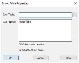

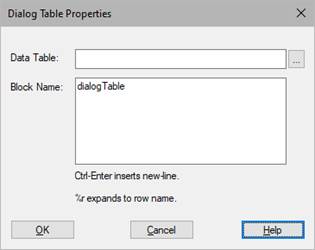

1. Right-click the dialogTable block.
The following dialog appears:
2. In the Data Table box, click ... to select the CSV data table.
3. You can optionally enter a new name for the block in the Block Name box.
4. Click OK, or press ENTER.

The Properties dialog appears, like the one shown below:
The field names in the header record are the parameter names in the dialog. The information from the first data record is displayed in the text boxes.
2. To display another data record, click the DOWN ARROW for the first parameter—in this case, Motor Type—and select the item whose data record you want displayed. Embed updates the information in the remaining text boxes accordingly.
