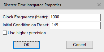

Clock Frequency: Establishes the integrator step time = 1/(clock frequency)
Initial Condition on Reset: Defines the initial value of the integrator output upon reset.

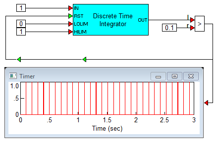

The Discrete Integrator block can be used to generate timing pulses. Set IN of the integrator to 1, and set the initial condition to 0. This causes the output of the Discrete Integrator block to ramp with the output value equal to simulation time. Compare this output to the desired interval between timing pulses, and feedback the comparator output to the RST input on the Discrete Integrator block. After completing a ramp cycle, the Discrete Integrator block is reset to 0. HILIM and LOLIM are arbitrary; however, they must be within the limits of the timing period.
