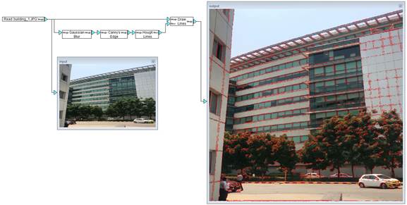

In this example, Canny’s Edge detects and retains edges that meet the threshold specifications. The Hough Lines block finds straight lines within the detected edges based on intersection, line length, and line gap specifications. The Draw Lines block displays the image with red lines drawn on the detected lines.
