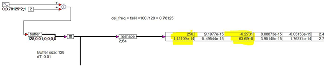

2. Computation of FFT with 100 Hz sampling frequency and 128 sampling points
In this example, each point in the FFT output array has a frequency resolution calculated as:
del_freq = Sampling_frequncy/No. of sampling points = 0.78125 Hz
The input signal has a frequency of freq_resoultion *2 = 1.5625 Hz and an offset of value 2.
In the FFT output, you see peaks only at point0 (dc offset) and point2 ( freq = 1.5625 Hz) highlighted in yellow.
