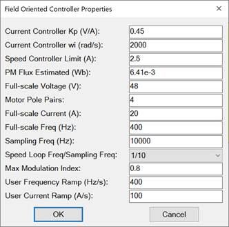

All inputs are divided by their respective full-scale values to get normalized values. For example, id_n = id_ref/C_fs, where id_ref is the user input and C_fs is the full-scale current.
Current Controller Kp (V/A): Indicates the proportional gain for the current loop.
Current Controller wi (rad/s): Indicates the bandwidth of the current controller. Typically limited to 2000 rad/s.
Full-scale Current (A): Indicates the full-scale current value for normalization.
Full-scale Freq (Hz): Indicates the full-scale frequency value for normalization.
Full-scale Voltage (V): Indicates the full-scale voltage value for normalization.
Max Modulation Index: Indicates the maximum
modulation index value (absolute), which is the radius of a circle in the
plane.
Motor Pole Pairs: Indicates the number of magnetic pole pairs of the motor.
PM Flux Estimated (Wb): Indicates the estimated or calculated permanent magnetic flux of the motor used.
Sampling Freq (Hz): Used by the controller. This should be set to the same frequency as set in System > System Properties.
Speed Controller Limit (A): Indicates the current limit for q-axis reference current used by the speed controller.
Speed Loop Freq/Sampling Freq: This ratio helps set the frequency at which the speed loop operates.
User Current Ramp (A/s): Indicates the safety limit to avoid sudden jerks in the input current values .
User Frequency Ramp (Hz): Indicates the safety limit to avoid sudden jerks in the input frequency values.
