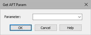

Description: The Get AFT Parameter block lets you choose which parameter to read and returns the current value of the parameter as it changes over time.
Parameter: Select from the following:
Parameter |
Description |
enableControl |
Returns the current value of the enableControl variable. |
enableRsEstimation |
Returns the current value of the enableRsEstimation value. |
Flux |
Returns the current flux value from the AFT. |
FluxEst |
Returns the estimated flux value from the AFT. The estimated flux value can be useable for IPM motors. |
Ld |
Returns the current value of Ld. |
Lq |
Returns the current value of Lq. |
obsgain |
Returns the current observer gain used by the AFT and derived from the AFT gain.
obsgan = AFT gain / rated flux2 |
Rs |
Returns the current value of the user-set stator resistance. |
RsEst |
Returns the current Rs estimate. |
Rs_recalb_on |
Returns the current value of Rs_recalb_on value. |
SpeedEst |
Returns the current value of the AFT estimated speed. |
