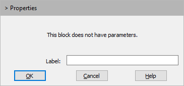

Right-click the > block to assign a different function to the block.

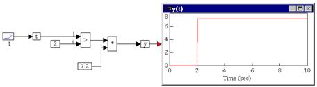

1. Simple if-then-else construct
Consider a variable y such that:
If t > 2 then y = 7.2; else y = 0
Assume that t is simulation time realized as:
By multiplying a constant value of 7.2 with the output of the > block, y is guaranteed to assume a value of 0 until the inequality is true. When the inequality is true, y assumes a value equal to the output of the * block.

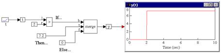

2. Modified if-then-else construct
Using the above equation, it can also be realized as:
The key difference in implementation is the use of a merge block rather than a * block. The merge block explicitly depicts the if-then-else structure, whereas the * block is a shortcut and can lead to confusion.
