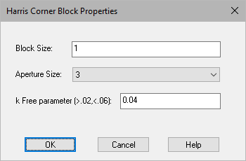

Block Size: Specifies the size of the neighborhood considered for corner detection.
Aperature Size: Specifies the aperature parameter of the Sobel derivative. The value you specify must be 1, 3, 5, or 7.
k(Free parameter): Specifies the Harris detector free parameter. The value you specify must be between 0.02 and 0.06.

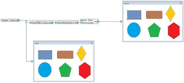

In this example, the corners of the diamond, pentagon, and hexagon are detected and highlighted.
