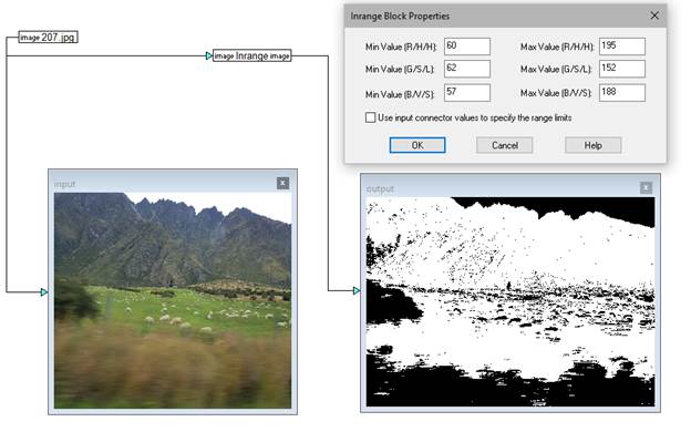

In this example, each pixel is examined to see if its RGB values fall within the specified ranges shown in the Inrange dialog. Pixel values within the ranges are white.
