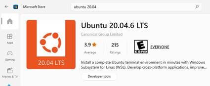

1. Make sure Windows Subsystem for Linux (WSL) Ubuntu 20.04.x LTS is installed on your computer. Because the ROS version is dependent on the WSL Ubuntu version, it is critical that you install WSL Ubuntu 20.04.x LTS.
To install WSL Ubuntu 20.04.x LTS:
a. Go to the Microsoft Store.
b. Search for Ubuntu 20.04.
c. Click Get to download and install Ubuntu 20.04.x LTS.
d. Click Open to run Ubuntu 20.04.x LTS.

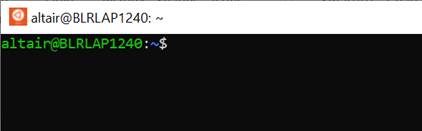

5. Open Ubuntu 20.04.x LTS from the Start menu.
A window similar to the following is displayed:

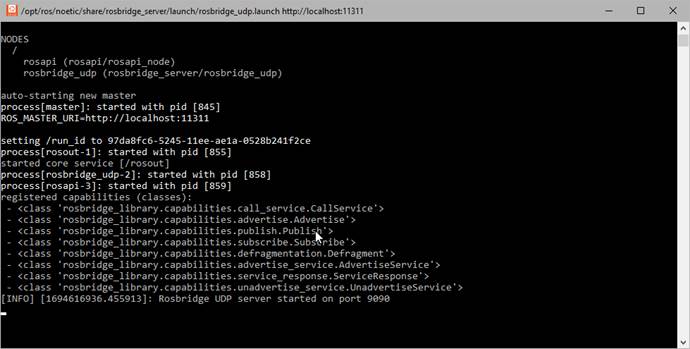

6. Enter one of following command to set up rosbridge, the server used to communicate with Embed.
•roslaunch rosbridge_server rosbridge_websocket.launch
•roslaunch rosbridge_server rosbridge_udp.launch
The following text is similar to what you’ll see when ROS is successfully installed on your computer, and the ROS Publisher and ROS Subscriber blocks are ready for use.
