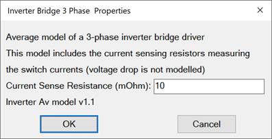

Description: The Inverter Bridge-3 Phase block is an average model of a three-phase inverter bridge. This block includes the current sensing resistors measuring the switch currents. The voltage drop is not modeled.

Current Sense Resistance (mOhm): Specifies the resistance value of the three-phase current sensing resistors. The output at v_Isense will then be Iout*Rsense for each of the three phases.
