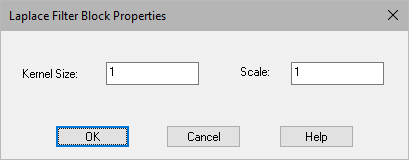

K Size: Specifies the aperture size used to compute the second derivative filter. The value must be odd and positive. The default is 1.
Scale: Specifies the scale factor for the computed Laplacian values. The default is 1.
