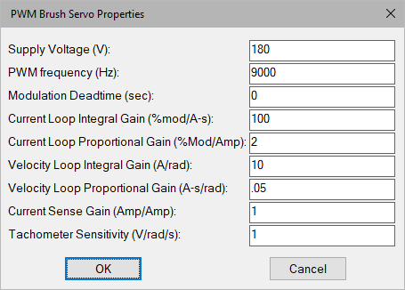

Current Loop Integral Gain: Typically sets the speed and tracking accuracy (bandwidth) of the current control loop.
Current Loop Proportional Gain: Typically sets the damping of the current control loop.
Current Sense Gain: Sets the current sensing device.
Modulation Deadtime (sec): Sets the switching deadtime between H-bridge device pairs. Note that the value of deadtime should be significantly smaller than the PWM frequency, but larger than the specified simulation frequency rate.
PWM Frequency: Sets the carrier frequency for the PWM. Note that the reciprocal of the simulation step size (simulation frequency) must be equal to or greater than the carrier frequency to perform a proper simulation.
Supply Voltage: Sets the voltage level output of the PWM.
Tachometer sensitivity: Allows you to rescale tachometer readings from volts to rad/sec. For example, if the known tachometer sensitivity is 200 V/rad/sec, enter this number into the tachometer sensitivity setting of the PWM Brush Servo Amplifier block to scale the reading back to rad/sec.
Velocity Loop Integral Gain: Typically sets the speed and tracking accuracy of the speed control loop.
Velocity Loop Proportional Gain: Typically sets the damping of the speed control loop.

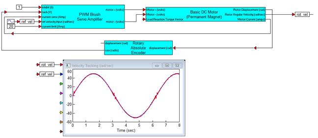

Diagram name: Brush PWM Servo AMP
Location: Examples > eDrives > eMotors (Legacy) > Brush DC
This example illustrates the single controller package solution for servo tracking control of a DC brush motor with current feedback. A rotary encoder provides the velocity feedback measurement.
