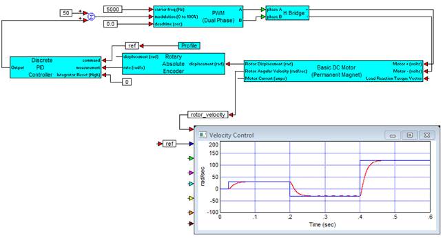

Description: The PWM-Dual Phase block provides a 2-phase pulse width modulated signal based on carrier frequency and modulation percent. Modulation is created using the triangular wave – threshold comparator technique.
Diagram name: PWM Dual Phase
Location: Examples > eDrives > eMotors (Legacy) > Brush DC
The following example illustrates how the 2-phase PWM can be used to control bi-directional velocity in a closed loop. The two PWM phases are fed to an H bridge power amplifier with voltage rails at ± 28 V. Modulation is biased at 50% from the output of a PI controller limited to ± 50% to prevent windup in the control. An encoder with rate estimation is used for feedback.
