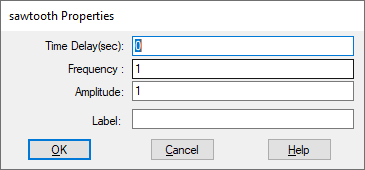

Description: The sawtooth block generates a unit sawtooth signal.
Amplitude: Specifies the maximum strength of the output signal. The default is 1. You can also enter a value in hexadecimal notation or as a C expression.
Frequency: Controls the frequency of oscillation of the output signal. Specify the frequency in hertz. The default is 1. You can also enter a value in hexadecimal notation or as a C expression.
Time Delay (sec): Indicates the time offset that is used in the calculation of the signal. The default is 0 sec. You can also enter a value in hexadecimal notation or as a C expression.
