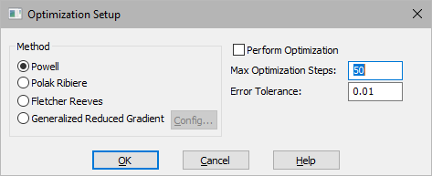

To perform global optimization, choose the optimization method in the System > Optimization dialog, then start the simulation.
Error Tolerance: Indicates the maximum error between the results of two successive iterations. The default is 10.
Fletcher Reeves: Specifies a conjugate gradient algorithm that requires fewer iterations to convergence. This algorithm is slower than Powell’s method.
Generalized Reduced Gradient: Specifies a generalized reduced gradient algorithm that performs constrained optimization. When you select this method, you can click Config to adjust tolerances and algorithmic options, and generate a report file.
Polak Ribiere: Specifies a conjugate gradient algorithm that is a bit more sophisticated than Fletcher Reeves for arriving at the supposed minimum of the quadratic form.
Powell: Specifies a direction-set algorithm that typically runs faster because it does not explicitly calculate the gradient.
Max Optimization Steps: Indicates the maximum number of optimization steps.
Perform Optimization: This parameter must be activated to perform global optimization.
Config: Invokes an editable table to adjust tolerances and algorithmic options that control the behavior of the Generalized Reduced Gradient algorithm. You are not required to take any action to use the default settings; however, at times, it may be necessary to set one or more of the parameters to a new value to make the optimizer more efficient or make it possible to solve a difficult problem. The new values remain in effect for the duration of the session.
