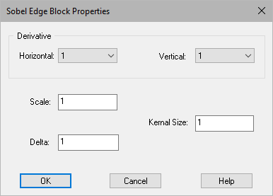

Delta: Specifies a value used to vary the pixel intensity. The delta value is added to the results prior to storing them in the output.
Derivative: Indicates the direction of edges to be detected. There are three supported combinations:
Horizontal derivative |
Vertical derivative |
Result |
1 |
0 |
Horizontal edges (y-gradient) detected |
0 |
1 |
Vertical edges (x-gradient) detected |
1 |
1 |
Calculates an approximation of the gradient (x-gradient and y-gradient) by combing both the horizontal and vertical derivatives |
Horizontal: Indicates an integer variable representing the x-derivative.
Vertical: Indicates an integer variable reprenting the y-derivative.
Kernel Size: Specifies a value used to extend the Sobel kernel. The value must be odd and positive and less than 32.
Scale: Indicates the scale value for the computed derivative values. The scale value helps to visualize a derivative in an image.
