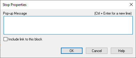

Include link to this block: Includes a URL to the stop block in the pop-up message. This is useful when there are multiple stop blocks in a diagram or the stop blocks are contained in different hierarchical levels of the diagram.

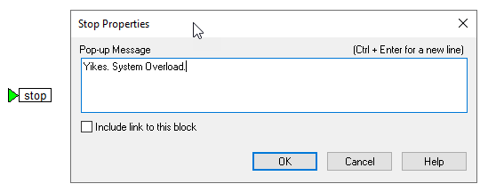

Pop-Up Message: Specifies a message that pops up on the screen when the simulation stops.

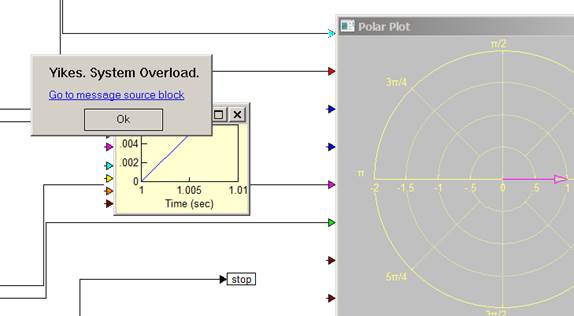

When the input to the stop block is 1, the simulation stops and displays the following message with a link back to the stop block.
Below is how the message appears when the simulation halts:
