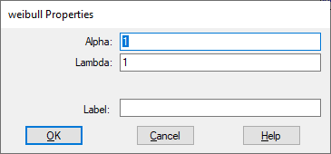

Alpha: Specifies the shape of the curve. You can enter a value in hexadecimal notation or as a C expression.
Lambda: Specifies the scale of the curve. As you increase the value of Lambda, curve is stretched. You can enter a value in hexadecimal notation or as a C expression.
