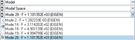

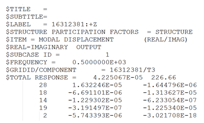

The MODOUT option is available to output the eigenvectors and the energy based on the eigenvectors of the same modal space associated with the corresponding modal participations output as part of the PFMODE entry. The modal space output via MODOUT respects the same filters and/or thresholds defined for the overall modal participation output on the PFMODE entry. For instance, if the number of modes for which the modal participations are calculated in the PFMODE entry is limited by say, STRUCTMP=5, then the same modal space containing the 5 modes is output for the Displacement and/or Energy eigenvectors requested via MODOUT.
In the example below, STRUCTMP=5 restricts the number of modes used for overall modal participation calculation to 5 (out a total number of 28 extracted modes).PFMODE(STRUCTURE, STRUCTMP = 5,RTYPE = DISP, PUNCH, MODOUT=21) = 2Therefore, you can see only 5 modes are used for modal participation output:Figure 1.
When the eigenvectors are requested using the MODOUT entry.MODOUT 21 HD3 + DISP ALLThe same 5 modes being output in the H3D file for the MODOUT request.Figure 2.
